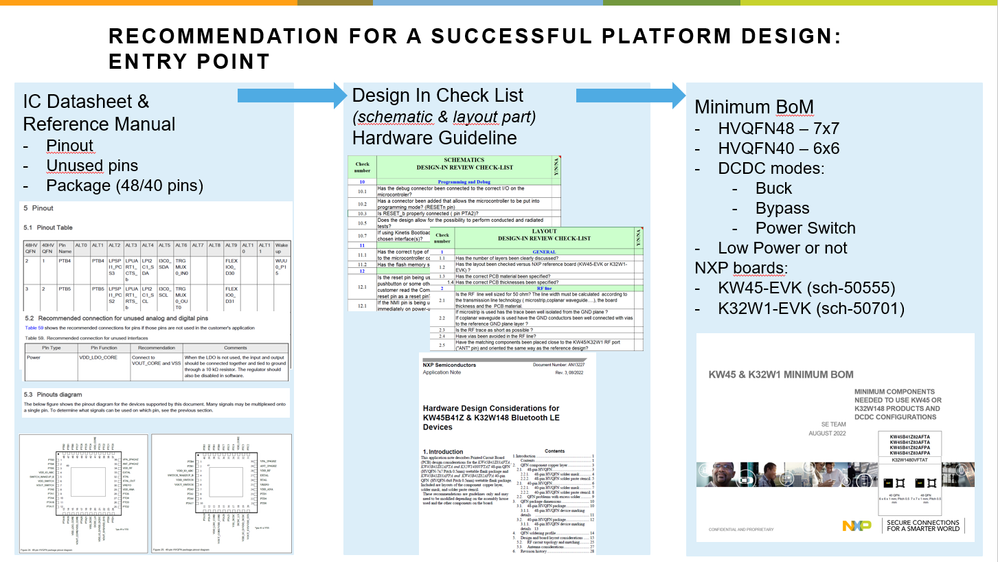

HARDWARE
  KW47 MCX W72 EVK board: attached
  KW47-MCXW72 LOCalization Channel Sounding board - diagram: preliminary attached
Do not used pre-production X-KW47LOC or MCXW72-LOC platform for Channel Sounding certification - contact NXP for further note
  KW47-MCXW72-EVK HW guideline: Available on request
      HVQFN48 package specification: SOT619-17(D)   pending release of SOT619-17(DD)
  KW47-MCXW72-EVK User Manual Available on request
     Minimum BoM (attached file) >> KW45 - MCX W71 - KW47 - MCX W72 Minimum BoM Presentation Customers August25.pdf
    DCDC management guide (AN13831) : KW45/K32W148 - Power Management Hardware (nxp.com) KW45 applicable for KW47 waiting release of KW47/...
    Design-In check list: see attached file at the bottom of this article
    RF matching: S parameters (attached file) Available on request
    How to handle coincell application on PCB:  AN14664_Coincell_Hardware_recommendation_Rev1.0.pdf
KW47-MCXW72 module can also be handled in standalone: How to run KW47-M2 standalone
