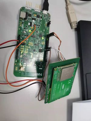

Hardware part:We need connect the PN7150 to KW36 like the picture. Although we can connect the PN7150 to board through the ardunio connector, the pin’s voltage is not enough to drive the PN7150. So we need a wire connected to U1 to get 3.3V.
PN7150
FRDM-KW36
VBAT/PVDD
3.3V
VANT
5V
GND
GND
IRQ
PTA16
VEN
PTC15
SCL
PTB0,I2C0
SDA
PTB1,I2C0

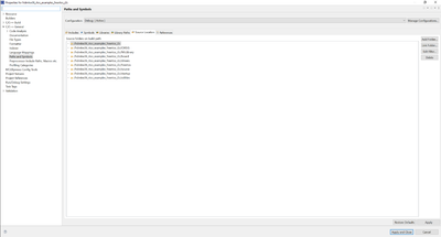

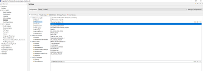

Software part:We should add the nfc library and directory into our project. You can check the following picture to know what file is necessary. If you want to know how to add directory into our project, you can refer this link.
The red line shows what file we need.

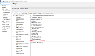

Please notice that when we add file path into the mcuxpresso configuration, we also need add the path into ‘Path and Symbols’ .
We need add some macro into ‘Preprocessor’.

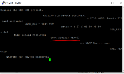

4 Results

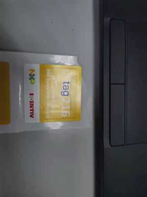

We use ntag to test the reading and writing operation.
When the tag is closed to the PN7150, we will get the following message.
The text recording is ‘VER=03’.

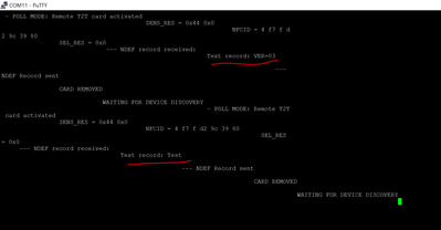

Next, we will modify the text recording
We need add the new macro to preprocessor.
We can modify the variable NDEF_MESSAGE in function task_nfc_reader to modify the text recording.

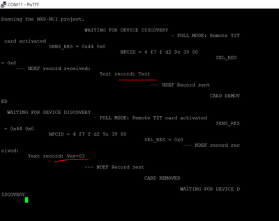

Then we download the program again. We will see the original text ‘VER=03’ and the text has been modified. Then we read the tag again. We will see the new text.

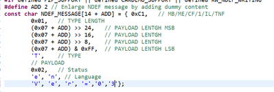

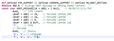

If we want to send the larger text, what should we do? We need modify the macro ‘ADD’.
When only 4 characters are sent, ‘ADD’ is 0. And every additional character is added, the ‘ADD’ will add. We modify the tag as ‘Ver=03’, and we have two more characters. So ‘ADD’ needs to be defined as 2
It firstly shows the text ‘Test’. Then it will show the new text ‘Ver=03’.
