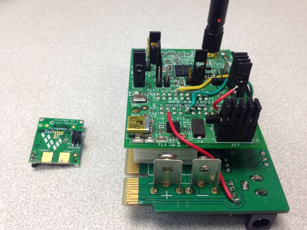

Hardware Requirements
MRB-KW019032 x 2
  •         MRB-KW019032 Board A: Connected with LF Emitter Board
  •         MRB-KW019032 Board B: Standalone
TPMS879011 x 1
LF Emitter Board x 1
Hardware Connection
Pin function
MRB-KW019032
LF Emitter Board
TPM1_CH0
PTB0 (J15-9)
J5-20
TPM1_CH1
PTB1 (J14-8)
J5-28
GND
GND (J15-2)
J6-4

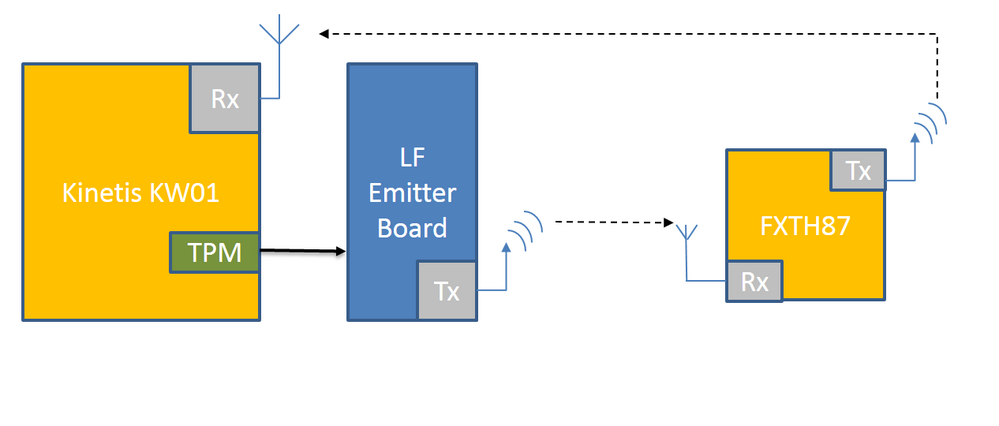

Demo Description
A prebuild TPMS870911 firmware is stored in MRB-KW019032 Board A and this firmware will be sent to TPMS870911 via 125kHz LF signal. After TPMS870911 completes the firmware update, TPMS870911 will send the information of pressure sensor to MRB-KW019032 Board B via 315 MHz RF signal.

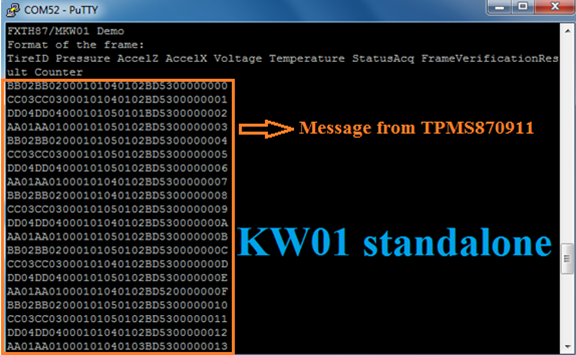

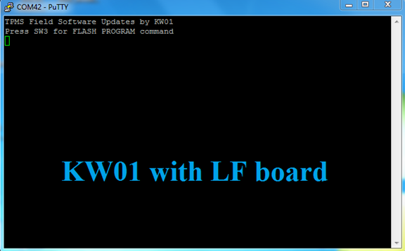

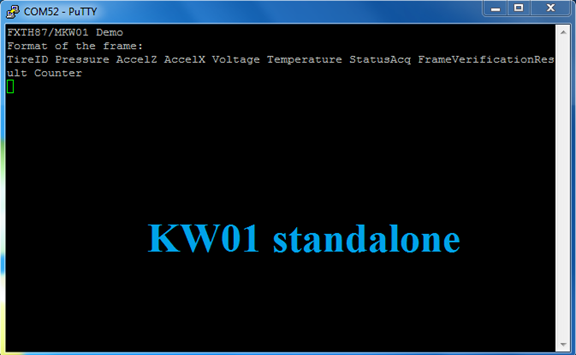

   5. Press the reset button on both of MRB-KW019032 boards and then the demo message will be shown on the terminal.

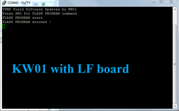

6. Short Pin19 of J15 (PTD6) on MRB-KW019032 Board A as SW3 press to start TPMS870911 over-the-air software update.
7. After TPMS870911 completes software update, MRB-KW019032 Board B will print the received RF message which was sent from TPMS870911 on the terminal.146535_146535.pngpastedImage_9.png
