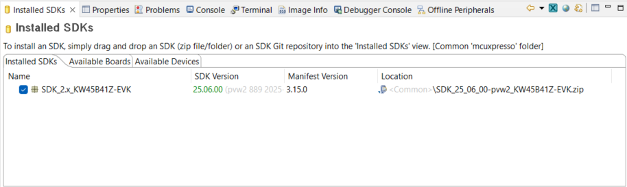

1 – SDK installation
  • Download the latest version of the KW45B41Z-EVK SDK package from MCUXpresso SDK Builder
  • Drag and drop the SDK zip file into the Installed SDKs window:

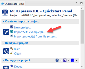

2 – Importing the project

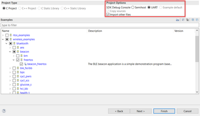

  • In the QuickStart Panel, click on Import SDK example
  • From wireless_examples, select beacon_freertos. It is recommended to select UART for Debug Console when using BLE projects.
  • Click on finish

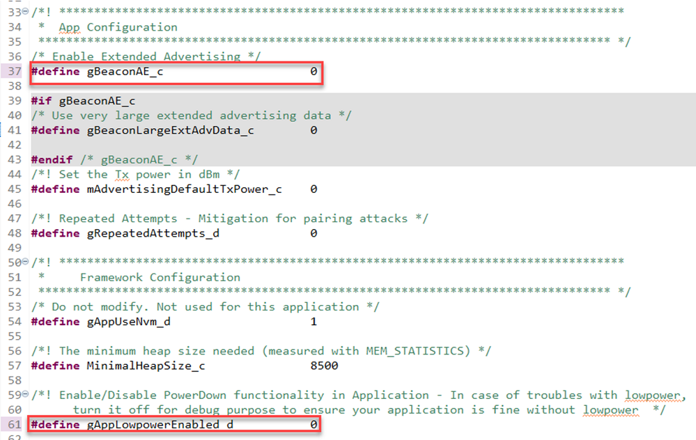

 1 – app_preinclude.h file:
  • Set the following definitions to "0" in order to disable Extended Advertising and Low Power functionality.

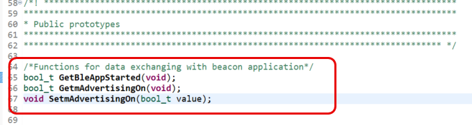

2 – app_advertiser.h file:
  • Add these aux prototypes that will allow to get and set the value of some flags.
/*Functions for data exchanging with beacon application*/
bool_t GetBleAppStarted(void);
bool_t GetmAdvertisingOn(void);
void SetmAdvertisingOn(bool_t value);

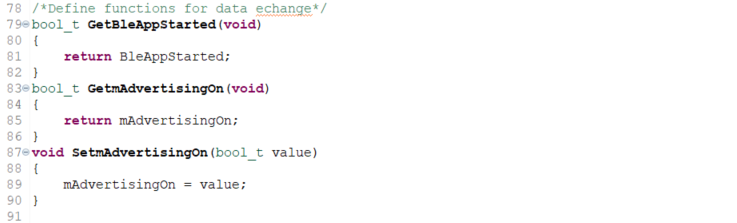

/*Define functions for data echange*/
	return BleAppStarted;
	return mAdvertisingOn;
	mAdvertisingOn = value;

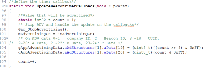

/*define the timer callback*/
static void UpdateBeaconTimerCallback(void * pParam)
	/*Value that will be advertised*/
	static int32_t count = 1;
	/* Stop ADV and handle the update on the callbacks*/
	Gap_StopAdvertising();
	mAdvertisingOn = !mAdvertisingOn;
	/* On ADV data 0-1 = company ID, 2 = Beacon ID, 3 -18 = UUID,
/* 19-20: A Data, 21-22: B Data, 23-24: C Data */
	gAppAdvertisingData.aAdStructures[1].aData[19] = (uint8_t)((count >> 8) & 0xFF);
	gAppAdvertisingData.aAdStructures[1].aData[20] = (uint8_t)(count & 0xFF);
	count++;

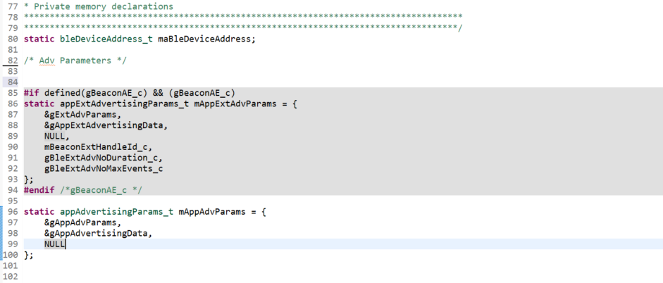

  •  Wrap the mAppExtAdvParams structure inside gBeaconAE_c definition macro to avoid problems with the declaration of the extended advertising parameters image.pngimage.png
#if defined(gBeaconAE_c) && (gBeaconAE_c)
static appExtAdvertisingParams_t mAppExtAdvParams = {
    &gExtAdvParams,
    &gAppExtAdvertisingData,
    NULL,
    mBeaconExtHandleId_c,
    gBleExtAdvNoDuration_c,
    gBleExtAdvNoMaxEvents_c
#endif /*gBeaconAE_c */

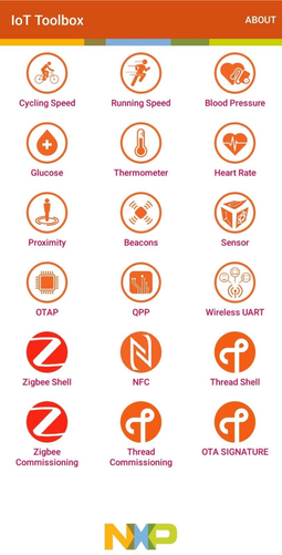

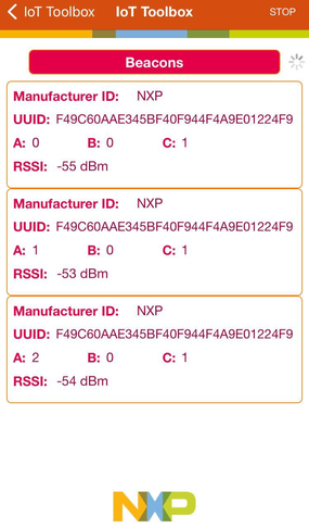

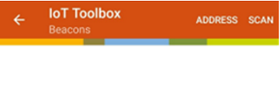

The IoT Toolbox is an all-in-one application that demonstrates NXP’s BLE functionalities, the implementation of BLE and custom profiles and the compatibility with different smartphones. This mobile application can be downloaded from the App Store and Google Play Store.

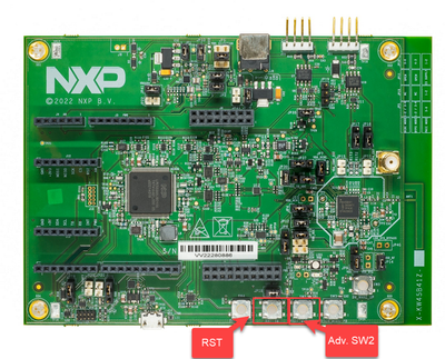

  • Press the USERINTERFACE Button (carrier board) to start advertising
  • In the IoT Toolbox app, you should be able to see the counter increasing its value every 5 seconds in the field "A"
