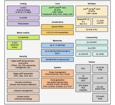

KW43 / KW43L are new product development. Iterating on KW45 and KW47, KW43 / KW43L are leveraging multi core architecture benefits with a twin Arm Core M33 implementation: multiple interfaces and latest security features intended to be supported. Focus is on best-in-class Real Time with one instance of Arm Core used for System Application while other is maximizing Radio/Wireless Activities. NXP remains committed to most secure, cost effective and advanced wireless solutions with all latest to anticipate future challenges.
Pin-to-pin compatibility with KW47/KW45:
Please refer to the sildes attached below for the pin-to-pin compatibility, thanks.
KW43 Block Diagram
