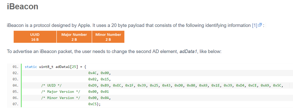

iBeacon
iBeacon is a protocol designed by Apple. It uses a 20 byte payload that consists of the following identifying information [1] :
To advertise an iBeacon packet, the user needs to change the second AD element, adData1, like below:
static uint8_t adData1[25] = {
                               0x4C, 0x00,
                               0x02, 0x15,
        /* UUID */             0xD9, 0xB9, 0xEC, 0x1F, 0x39, 0x25, 0x43, 0xD0, 0x80, 0xA9, 0x1E, 0x39, 0xD4, 0xCE, 0xA9, 0x5C,
        /* Major Version */    0x00, 0x01
        /* Minor Version */    0x00, 0x0A,
                               0xC5};

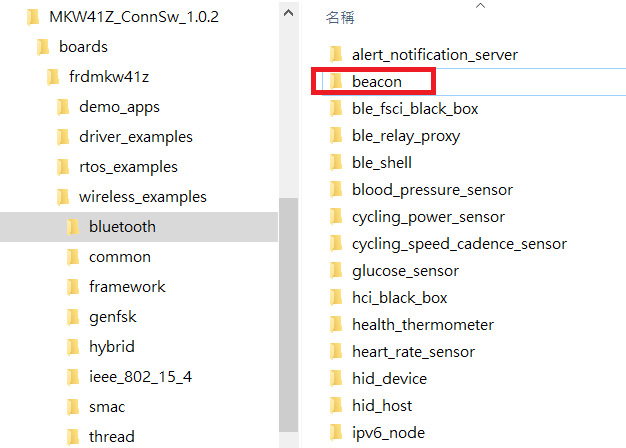

Dear sir,
I tried to implement ibeacon feature on KW41z.
I used the beacon example in MKW41Z_ConnSw_1.0.2.
The default packet is NXP beacon format.
I tried to change it to ibeacon packet format like you mentioned below.
I used the beacon app "Locate" from App store. But I can't get my KW41 device.
Could you help me how I could implement the ibeacon feature on KW41 successfully.
Thanks.
