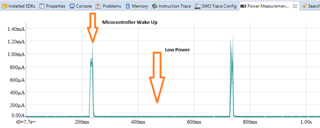

FreeRTOS keeps track of the elapsed time in the system by counting ticks. The tick count increases inside a periodic interrupt routine generated by one of the timers available in the host MCU. When FreeRTOS is running the Idle task hook, the microcontroller can be placed into a low power mode. Depending on the low power mode, one or more peripherals can be disabled in order to save the maximum amount of energy possible. The FreeRTOS tickless idle mode allows stopping the tick interruption during the idle periods. Stopping the tick interrupt allows the microcontroller to remain in a deep power saving state until a wake-up event occurs.

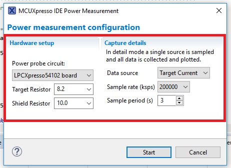

The application needs to configure the module (timer, ADC, etc…) that will wake up the microcontroller before the next FreeRTOS task needs to be executed. For this purpose, during the execution of vPortSuppressTicksAndSleep, a function called by FreeRTOS when tickless idle is enabled, the maximum amount of time the MCU can remain asleep is passed as an input parameter in order to properly configure the wake-up module. Once the MCU wakes up and the FreeRTOS tick interrupt is restarted, the number of tick counts lost while the MCU was asleep must be restored.
Tickless mode is not enabled by default in the Connectivity Software FreeRTOS demos. In this post, we will show how to enable it. For this example, we will use QN9080x to demonstrate the implementation.

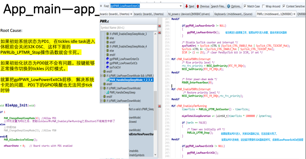

*** PWR.c ***
Add the driver for RTC. This is the timer we will use to wake up the QN908x
/*Tickless: Add RTC driver for tickless support */
#include "fsl_rtc.h"‍‍‍‍‍‍‍‍‍‍‍‍‍‍‍‍
Add local variables
uint64_t mLpmTotalSleepDuration;        //Tickless
uint8_t mPWR_DeepSleepTimeUpdated = 0;  //Tickless: Coexistence with TMR manager‍‍‍‍‍‍‍‍‍‍‍‍‍‍‍‍
Add private functions
 uint32_t PWR_RTCGetMsTimeUntilNextTick (void);         //Tickless
 void PWR_RTCSetWakeupTimeMs (uint32_t wakeupTimeMs);   //Tickless
 void PWR_RTCWakeupStart (void);                        //Tickless‍‍‍‍‍‍‍‍‍‍‍‍‍‍‍‍‍‍‍‍‍‍‍‍
Make the following changes in PWR.C. All the required changes are marked as comments with "Start" where the change starts, and with "End where the change ends"
#if (cPWR_UsePowerDownMode && (cPWR_EnableDeepSleepMode_1 || cPWR_EnableDeepSleepMode_2 || cPWR_EnableDeepSleepMode_3 || cPWR_EnableDeepSleepMode_4))
static void PWR_HandleDeepSleepMode_1_2_3_4(void)
#if cPWR_BLE_LL_Enable
    uint8_t   power_down_mode = 0xff;
    bool_t    enterLowPower = TRUE;
    __disable_irq();
/****************START***********************************/
    /*Tickless: Configure wakeup timer */
    if(mPWR_DeepSleepTimeUpdated){
      PWR_RTCSetWakeupTimeMs(mPWR_DeepSleepTimeMs);
      mPWR_DeepSleepTimeUpdated = FALSE;        // Coexistence with TMR Manager
    PWR_RTCWakeupStart();
/*****************END**************************************/
    PWRLib_ClearWakeupReason();
    //Try to put BLE in deep sleep mode
    power_down_mode = BLE_sleep();
    if (power_down_mode < kPmPowerDown0)
        enterLowPower = false; // BLE doesn't allow deep sleep
    //no else - enterLowPower is already true
    if(enterLowPower)
/****************START**************************/
        uint32_t freeRunningRtcPriority;
/****************END****************************/
        NVIC_ClearPendingIRQ(OSC_INT_LOW_IRQn);
        NVIC_EnableIRQ(OSC_INT_LOW_IRQn);
        while (SYSCON_SYS_STAT_OSC_EN_MASK & SYSCON->SYS_STAT) //wait for BLE to enter sleep
            POWER_EnterSleep();
        NVIC_DisableIRQ(OSC_INT_LOW_IRQn);
        if(gpfPWR_LowPowerEnterCb != NULL)
            gpfPWR_LowPowerEnterCb();

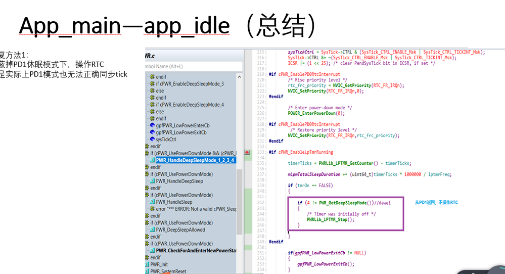

/* Disable SysTick counter and interrupt */
        sysTickCtrl = SysTick->CTRL & (SysTick_CTRL_ENABLE_Msk | SysTick_CTRL_TICKINT_Msk);
        SysTick->CTRL &= ~(SysTick_CTRL_ENABLE_Msk | SysTick_CTRL_TICKINT_Msk);
        ICSR |= (1 << 25); // clear PendSysTick bit in ICSR, if set
/************************START***********************************/
        NVIC_ClearPendingIRQ(RTC_FR_IRQn);
        freeRunningRtcPriority = NVIC_GetPriority(RTC_FR_IRQn);
        NVIC_SetPriority(RTC_FR_IRQn,0);
/***********************END***************************************/
        POWER_EnterPowerDown(0); //Nighty night!
/************************START**********************************/
        NVIC_SetPriority(RTC_FR_IRQn,freeRunningRtcPriority);
/************************END************************************/
        if(gpfPWR_LowPowerExitCb != NULL)
            gpfPWR_LowPowerExitCb();
        /* Restore the state of SysTick */
        SysTick->CTRL |= sysTickCtrl;
        PWRLib_UpdateWakeupReason();
    __enable_irq();
#else
#endif /* cPWR_BLE_LL_Enable */
#endif /* (cPWR_UsePowerDownMode && cPWR_EnableDeepSleepMode_1) */

We can monitor the power consumption in MCUXpresso IDE, with the Power Measurement Tool. With it, we can see the current that is been consumed and prove that the implementation is working as the expected.
Configure the Power Measurement Tool
Consumed current
Comments

However, there is one trap, need take care.
If recovery from power mode PD1, in tickless idle task, which has closed 32K OSC before sleep,  PWRLib_LPTMR_Stop  will crash to operate unpower peripherals.
if Power mode is PD0, the issue couldn't be seen for OSC working and stay powered during sleep.
How to fix:
Judge recovery from PD1 or PD0.
