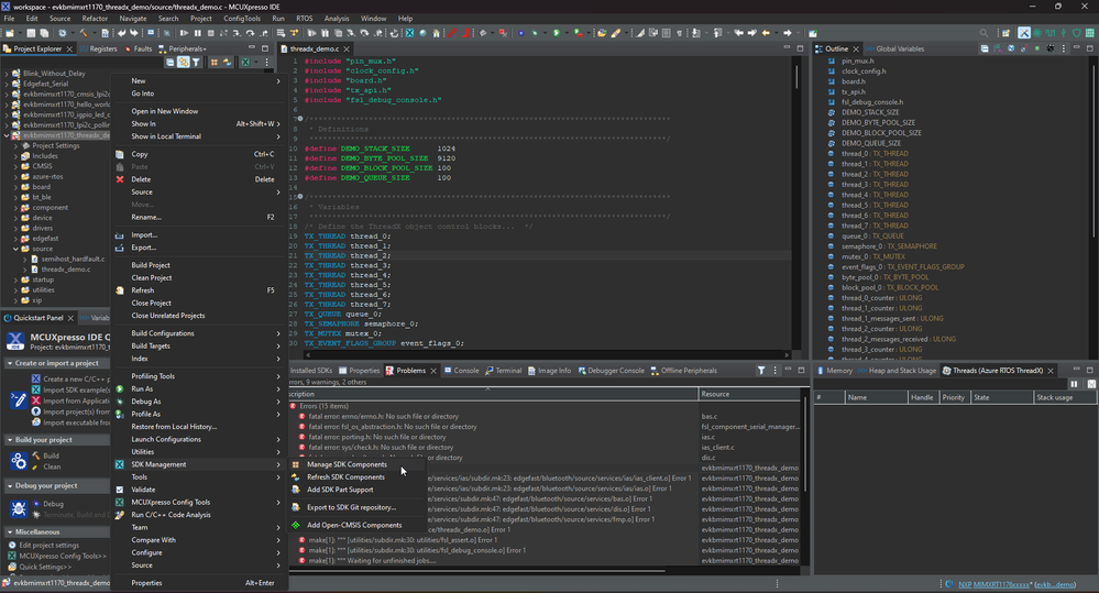

Lizardkomodo
Yes I am using the same example. Here is what I did.
First I open my IDE.
Then after picking my default workspace I Import an SDK example from the main menu.
I select my board
Then click next to import the threadx example.
2024-05-20 17_49_42-SDK Import Wizard.pngAfter I click on "Finish" the project is in my workspace and I can open it. Now i click on SDK manager to import the middleware.
From here I select the Edgefast Bluetooth Middleware.
2024-05-20 17_50_50-workspace - evkbmimxrt1170_threadx_demo_source_threadx_demo.c - MCUXpresso IDE.png
A prompt asks me this. to which I click "Yes"
2024-05-20 17_51_01-workspace - evkbmimxrt1170_threadx_demo_source_threadx_demo.c - MCUXpresso IDE.png
After it has finished loading, then i click to Build the Project.
After the project finishes building I receive multiple errors.
2024-05-20 17_53_32-workspace - evkbmimxrt1170_threadx_demo_source_threadx_demo.c - MCUXpresso IDE.png
2024-05-20 17_53_41-workspace - evkbmimxrt1170_threadx_demo_source_threadx_demo.c - MCUXpresso IDE.png

Christine_Li
Hi, @Lizardkomodo
I reproduced partially your errors.
To solve the problem, I think you need to import the head files from SDK into your workspace.
You can search the file which not found when build, and search the name in your SDK directory, after found the file location, then copy it into your workspace related location.
I am trying on my local side, too.
Christine.

Christine_Li
Hi, @Lizardkomodo
Actually I haven't resolved all of the errors on my side.
But there are two ways you can try:
1. According to the errors, copy the needed files from SDK directory to where it requests. I believe you have downloaded our SDK from our website and also imported it to MCUXpresso IDE. You can find where is your SDK, unzip it, and find the needed files by searching the name of related files. But as our experience, directly import the whole edgefast bluetooth middleware to another separate demo example will  encounter a lot of errors. And to resolve these compile errors might take a lot of your time.
2. Do not directly import the whole middleware, but only import what you need and add requested files.
This way might be a better way for whom isn't very familiar with the whole code structure.
Why don't you use our default Demo example and do some customized based on it?
Actually it has been out our support, to import some middleware to some demo examples. It is customization part of customers.
Christine.
