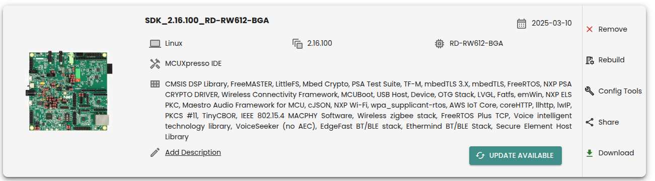

Yes, I am using the proper SDK, from which I have already tried and tested a few other examples that worked fine. However, after I created a custom example and flashed it, this problem arose. this is the version of the sdk i am using SDK_2.16.100_RD-RW612-BGA.
