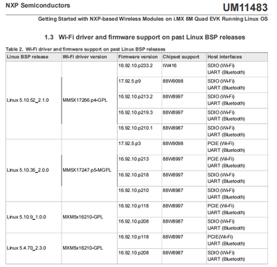

Hi, NXP Experts
I use linux v5.4 kenerl from NXP yocto on my AW-CM276 sdio wifi modules(chipset is W8997). And i have change kernel/drivers/net/wireless/nxp/mxm_wifiex/wlan_src/Makefile to support my sdio wifi, see below:
@@ -28,10 +28,10 @@ CONFIG_PCIE8897=n
CONFIG_SD8977=n
CONFIG_SD8978=n
CONFIG_USB8978=n
-CONFIG_SD8997=n
+CONFIG_SD8997=y
CONFIG_USB8997=n
CONFIG_PCIE8997=n
-CONFIG_SD8987=y
+CONFIG_SD8987=n
CONFIG_SD9097=n
CONFIG_USB9097=n
CONFIG_PCIE9097=n
Now wifi seems work fine both wifi(ap/sta mode) and bluetooth.
And i have tried the firmware sdsd8997_combo_v4.bin from https://git.kernel.org/pub/scm/linux/kernel/git/firmware/linux-firmware.git/tree/mrvl and sdsd8997_combo_v4.bin form Marvell's SD-WLAN-SD-BT-8997-U16-MMC-W16.68.10.p137-16.26.10.p137-C4X16687_V4-MGPL\FwImage, but both face RFtest interface can not work, i refer Chapter 2.8 of NXP pdf Feature Configuration Guide for NXP-based Wireless Modules on i.MX 8M Quad EVK - User manual (public... . see below:
root@root:/proc/mwlan/adapter0# ls
config p2p0 uap0 wlan0
root@root:/proc/mwlan/adapter0# pwd
root@root:/proc/mwlan/adapter0# echo "rf_test_mode=1" >>config
root@root:/proc/mwlan/adapter0# cat config
hardware_status=0
netlink_num=31
drv_mode=7
sdcmd52rw=0 0x0 0x00
(Do not exist rf_test_mode=1)
root@Router:/proc/mwlan/adapter0#
My qustions:
1. How can i dual with this issue?
2. Is there a special mfg wifi fireware for RFtest?
3. How can i get the w8997 sdio wifi firmwares matched to the drivers/net/wireless/nxp/mxm_wifiex of NXP linux kernel 5.4?

since i upgrade mwifiex driver in my linux5.4 to the newest version one(branch remotes/origin/lf-5.10.72_2.2.0 of git http://source.codeaurora.org/external/imx/mwifiex (mxm5x17283.p2))  and use the newest firmware  nxp/FwImage_8997_SD/sdiouart8997_combo_v4.bin(branch remotes/origin/lf-5.10.72_2.2.0 of git https://github.com/NXP/imx-firmware.git (SDIO-UART W8987 Firmware version 16.92.21.p11.1)),  the below RFtest cmd test seams works:
hardware_status=0
netlink_num=31
drv_mode=7
rf_test_mode=1
tx_antenna=1
rx_antenna=1
band=0
bw=0
channel=
radio_mode[0]=
radio_mode[1]=
total rx pkt count=0
rx multicast/broadcast pkt count=0
rx fcs error pkt count=0
tx_power=
tx_continuous=0
tx_frame=0
he_tb_tx=0
I use branch lf-5.10.72_2.2.0 because the lastest update both mwifiex driver and sd firmware is at Nov-15-2021. which is the newest among all branches.
 Now i have two qustions:
1. I use branch remotes/origin/lf-5.10.72_2.2.0 mwifiex driver and sd firmware for my linux5.4.24 kernel above,is any risk?
2. how can i find  the newest firmware sdsd8997_combo_v4.bin (both wifi and bluetooth use sdio interface) ,which matched mwifiex driver version mxm5x17283.p2, eg  16.92.21.p11.1?  i can't find it in https://github.com/NXP/imx-firmware.git
6,296 Views

estephania_mart
I apologize for the inconvenience this might cause you, but we do not have a roadmap with the updates on the branches.
The version of Firmware is in one-to-one correspondence with the Linux kernel version, so, please do not mix the driver and FW versions between different kernel's versions.
Estephania
