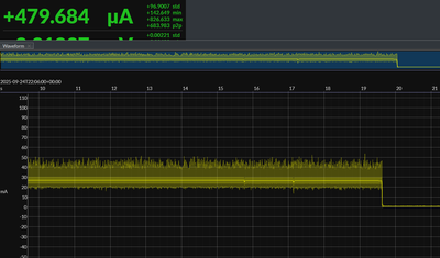

To further investigate, I tested with two FRDM-RW612 development kits, without making any rework or modifications, and programmed both with the Power Manager Test (bare-metal) sample application from the NXP SDK v25.6.0.
On DK1, measuring current through JP9, the PM4 current consumption is around 400 µA, which is as expected.
On DK2, under the exact same test conditions, the PM4 current consumption is around 1 mA. I repeated this test 120 times, and the results were consistently the same.
Interestingly, when I applied hot air to DK2, the PM4 current dropped to ~400 µA (normal value). But after a few minutes of cooling, the current rose back to ~1 mA. Reapplying hot air again would temporarily bring the current back down.

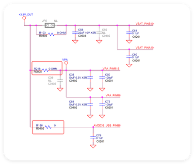

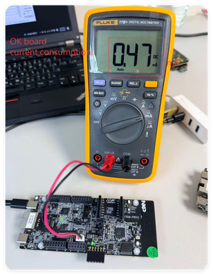

I used three current meters to measure JP9, JP5, and JP7.
The results are as follows:
FRDM1(O.K case) JP9:474mA JP5:21uA JP7:444uA.
FRDM2(K.O case) JP9:1.26mA JP5:21uA JP7:448uA.
In K.O.'s case, I noticed that JP9 consumed 1.26mA, but JP5 and JP7 combined consumed 469uA. This means that I have approximately 800mA of leakage coming from somewhere below the JP9 node.

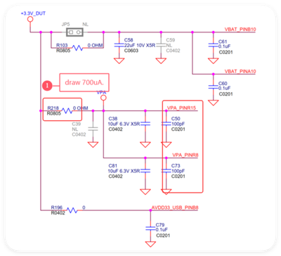

Hi Daniel.
I've identified the 700µA "gap current"; my measurements show that this current is being drawn from the VPA pin. Is this issue something that can be resolved through software updates or patches? We have already purchased 1560 units from U-blox, and our client is about to undergo RF certification in six different countries. I need to know if this problem can be fixed.

We used the uBlox IRIS-W106-30B module.
We opened the shielding cover and measured the current leakage in the ublox IRIS-W106-30B module under a specific test condition (K.O. case). We found a current leakage of 657 µA at VPA.
Therefore, based on the experimental results, the source of the leakage current in both the FRDM612 and ublox IRIS-W106-30B appears to be the current drawn from the VPA.

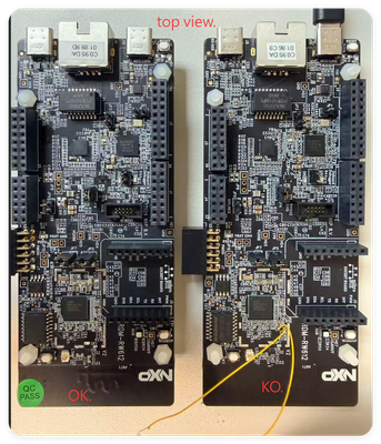

By the way, could you please tell me what the cables in the KO FRDM are for?

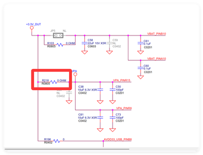

Hi Daniel.
The K.O. board yellow cable for measuring VPA current.
I've removed the R218 for measuring the VPA current

Hi Daniel.
The yellow cable on this K.O. board is used to measure the current of VPA with 0 ohms resistance(R218).

Hi Daniel.
My FRDM's picture is below:

Also, I looked at the power tree after JP9, except for JP7 and JP5.
If I want to analyze this further, can I only measure R218 and R196 to identify the power consumption sources? Would measuring the power tree of these two paths be helpful to you?
I have uploaded the FRDM612 schematic in the attached file.
