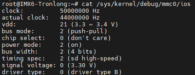

The clock of SDIO automatically set to 50MHz.And actually running at 44MHz.
Can anyone help me?If I should offer more information to further deal with this issue,please tell me.

udhcpc -i mlan0
sleep 3
ifconfig
