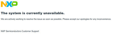

Just to inform you that I still can't access the download at the link.
There is still this message when it is attempted.
Mark
