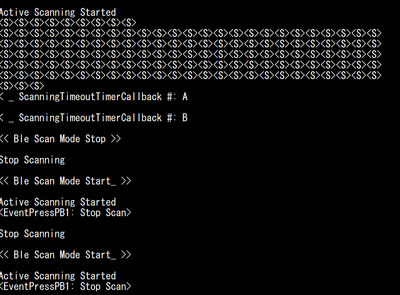

I am using MKW38[FRDM-KW38 board].
Based on Example code [adv_ext_central_freertos],
I am trying to Always Scan mode.
I added debug message "<S>" when adv device is found.
When I conduct Long run test. a certain time[ex: 72hours later] Scanning doesnot work anymore.
At this moment, and from this moment. scanstop & ScanStart does not work.
[After scanstop & scanstart, Scanning does not work anymore].
Can Anybody help to conduct never stop scan ?

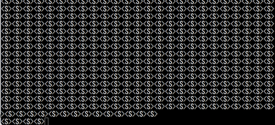

JungkyuHan1
Dear @Christine_Li
<S>  -> mean found ble device (do not try to connect)
after hours <S> does not shown

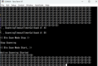

I have conducted long run test with new binary (BLE Scan Stop -> Start repeat every 60 second)
but still has problem. after 24hours one of two device does not scan any more.

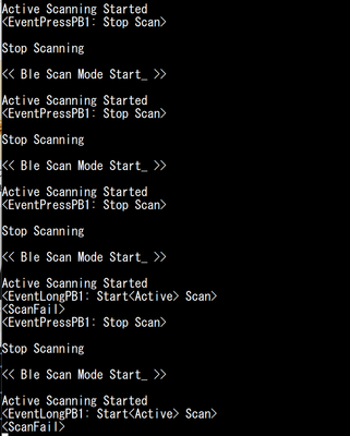

JungkyuHan1
SDK : 2.6.xx
As I tested two options but same result,
1.Sustain Scan Start for Good.   : SCAN fail
2.Repeat -Scan Start (60s) -> Scan Stop   : SCAN fail

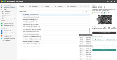

Christine_Li
Hi, @JungkyuHan1
You can visit this website:
https://mcuxpresso.nxp.com/select
input KW38, choose FRDM-KW38, then click the SDK version, it will list all of SDKs.
Please see below screenshot.
Christine.

As you can compre to org example code.
What I just modified is that "Scan Restart" when scan stop timer expired.
[with some debug message].
