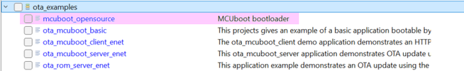

Import MCUBOOT_OPENSOURCE example
  1. Select Import SDK Example and select the board you are working with. Browse the ota_examples to find the mcuboot_opensource example. Select this and press Next.Sabina_Bruce_0-1739206162940.png

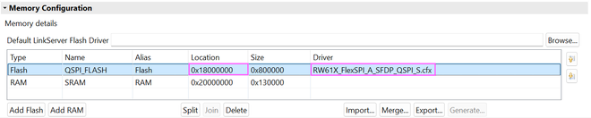

  2. The following window will contain the memory configuration of the example. It is important to change the Location address(0x18000000) to the secure alias and the Driver(*_S.cfx) to the secure version of the driver. Then press Finish.

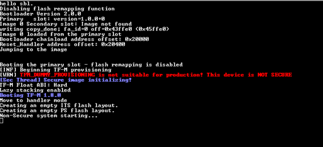

  3. Locate the flash_partioning.h header file within the project to determine the start address of where the TF-M secure image will be located. This will be represented by the BOOT_FLASH_ACT_APP macro.
    #define BOOT_FLASH_ACT_APP 0x18020000.
    In this example, I know that the secure image should be located in the offset 0x20000. Additionally, using MCUBoot means that we will have a header attached to the image when signed, this will add an addition 0x400. In total my offset will be 0x20400

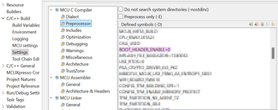

  4. Open the preprocessor configurations in the project by right clicking the project and select Properties. With the window open navigate to the following location:
    C/C++ Build -> Settings -> MCU C Compiler -> Preprocessor
    Set BOOT_HEADER_ENABLE = 0
  5. Press Apply and Close. Build mcuboot image.

  2. Open the preprocessor configurations in the project by right clicking the project and select Properties. With the window open navigate to the following location:
    C/C++ Build -> Settings -> MCU C Compiler -> PreprocessorSabina_Bruce_7-1739208460648.png

  6. Edit the S_IMAGE_PRIMARY_PARTITION_OFFSET macro. Based on the calculated above, the offset used in this example of the primary image will be 0x20400.
    #define
    S_IMAGE_PRIMARY_PARTITION_OFFSET (0x20400)
  7. Edit the M_BOOT_FLASH_CONF_START macro. This should be the same as the base address being used in MCUBoot's BOOT_FLASH_ACT_APP.
    #define M_BOOT_FLASH_CONF_START (0x18020000)

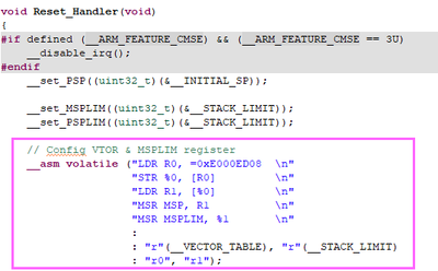

  8. Open the startup_*board*.c source file under the following folder:
    tf-m/platform/ext/target/nxp/*board*/Device/SourceSabina_Bruce_5-1739208027724.png
  9. Edit the void Reset_Handler(void) function. Add the VTOR configuration so that it points to the top of the vector table.
    // Config VTOR & MSPLIM register
    __asm volatile ("LDR R0, =0xE000ED08 \n"
    "STR %0, [R0] \n"
    "LDR R1, [%0] \n"
    "MSR MSP, R1 \n"
    "MSR MSPLIM, %1 \n"
    : "r"(__VECTOR_TABLE), "r"(__STACK_LIMIT)
    : "r0", "r1");
    *Note: This step is only done on the secure image.

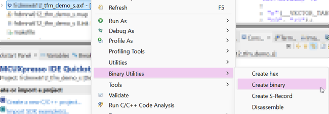

Generate Binaries
  1. Under the Debug folder you will find the .axf file generated automatically by MCUXpresso IDE under the secure project.
  2. Right click on this and navigate to Binary Utilities -> Create Binary. Sabina_Bruce_8-1739208817995.png
  3. Repeat for non-secure image.

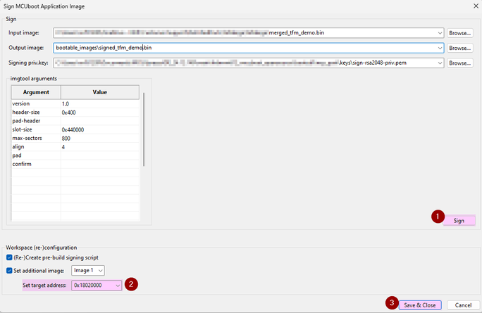

Use Secure Provisioning Tool to Sign Images
Note: This article does not show detailed steps of using MCUXpresso Secure Provisioning Tool. If detailed steps are needed please refer to the its user guide available in the Help Menu of the tool.
  1. Select the MCUBOOT_OPENSOURCE image as your source.Sabina_Bruce_9-1739209324789.png
  3. Select the merged binary as your source. The output image should be filled automatically to the bootable_images folder of the secure provisioning workspace. Select the key used to authenticate the image. In mcuboot_opensource workspace there is a key folders that contain example keys used for development.Sabina_Bruce_11-1739209589501.png
4. Press Sign, then make sure that the target address matches the based address defined in the mcuboot for the primary partition, then save & close.
5. Build and Write Image accordingly with the Secure Provisioning Tool.
Run Application
