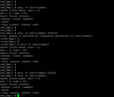

Just to narrow down my issue in one line,
I am facing an issue with updating the Bluetooth baud rate on my device. Currently, Bluetooth only works with a baud rate of 115200. Here are the details:
  1. I cannot set the baud rate to any value other than 115200; if I do, Bluetooth stops working.
  2. I've updated the bt_vendor.conf file, but the issue persists.
  3. Using the stty tool, I cannot set the baud rate to 3M. However, I can set it to 921600. Below is the image attached for your reference.
  4. I'm using mlan.ko to load the Wi-Fi and Bluetooth combo firmware.
My questions are:
  1. Could this be an issue with the libbt code?
  2. Are there other settings I need to change besides bt_vendor.conf to update the baud rate?
  3. Is it possible that my firmware is not compatible with baud rates other than 115200?
  4. Could mlan.ko be configuring the baud rate to work only with 115200?
Any help or insights on resolving this issue would be greatly appreciated. Thank you!

10,931 Views
rikinrshah
Hi @Christine_Li ,
Thanks for your response.
1.  No, I don't think so. I suspect it is a HW UART issue or the stty tool doesn't support 3M. Need to do some research and confirm.
-> I  do not think that it would be a  HW UART issue because it is working fine when we flash the Yocto image in it (Baud rate = 921600).
PS: We getting proper audio without glitches.
-> stty supports 3M baud rate. We confirmed this my updating the baud rate in the another board (mek_8qm) present with us.
2. As I know, we change the baud rate through this config file or change it in driver source code.
-> Can you please provide any information regarding where can we do changes in driver source code?
3. No, our FW should support 3M.
-> Okay, Noted!
4. There is no relationship with mlan.ko, mlan.ko is Wi-Fi driver, it has no relationship with BT UART baud rate.
-> Okay, Noted!
###Can you please try to download one of our Linux prebuilt image, and try to change baud rate to see whether has any HW issue on your board
-> Our Yocto linux is also working fine. Problem is with android.
###Are you using 88W8997 module? or your own designed board with 88W8997 chips
-> I am using Toradex Verdin IMX8MP.
Rikin
10,918 Views

rikinrshah
Hi @Christine_Li,
Thanks for your help throughout.
We are now able to set the baud rate to 3M and are also able to get proper audio without glitches.
Effective changes done:
1. Added assigned-clocks and assigned-clock-parents variables to uart4 node (BT node in my case) in imx8mp-verdin-wifi.dtsi file.
&uart4 {
 	uart-has-rtscts;
 	pinctrl-names = "default";
 	pinctrl-0 = <&pinctrl_bt_uart>;
        assigned-clocks = <&clk IMX8MP_CLK_UART4>;
        assigned-clock-parents = <&clk IMX8MP_SYS_PLL1_80M>;
 	status = "okay";
2. Remove unnecessary macros from the bt_vendor.conf. Only kept the macros which we wanted to update from their respective default values.
mchar_port = /dev/ttymxc3
is_uart_port=1
Rikin
10,678 Views
