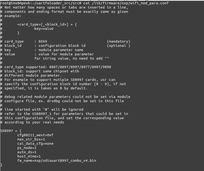

In my case, if I didn't run "modprobe moal mod_para=nxp/wifi_mod_para.conf" ever, I can attach bluetooth successfully. However, Bluetooth initialize failed if I init wifi driver before. And if i init Bluetooth before, it will fail to init wifi.

This is the wifi_mod_para.conf"
Is any idea for this?
Thanks a lot!
