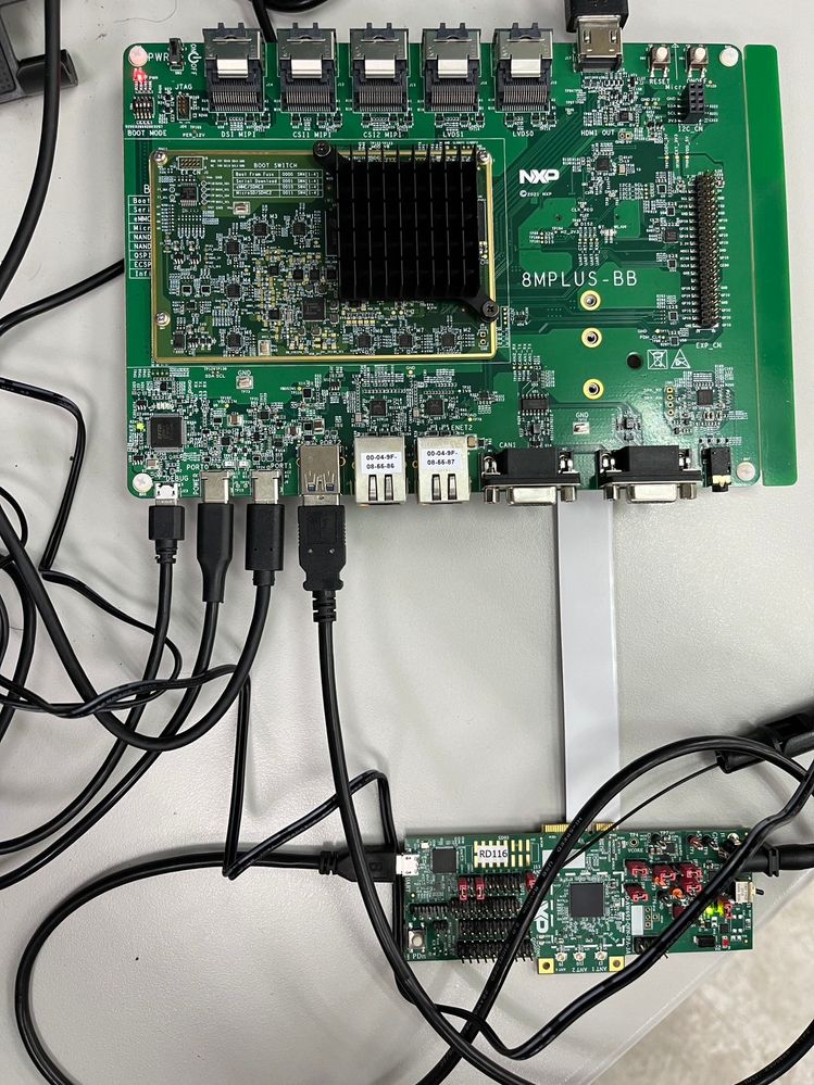

ChChang
Attachment is my complete booting log,
Do I need to change the UART name?
If so, what should be the name for the AW693 Bluetooth to use?
And what files need to be modified ?
Thanks!
CH

ChChang
When I connect the AW693 EVB to the i.mx8mp-evk (Android 13),
/dev/ttyUSB0 is not generated. I checked the imx_v8_android_defconfig,
and it contains:
CONFIG_USB_SERIAL=y CONFIG_USB_SERIAL_CONSOLE=y CONFIG_USB_SERIAL_GENERIC=y CONFIG_USB_SERIAL_SIMPLE=y CONFIG_USB_SERIAL_CP210X=m CONFIG_USB_SERIAL_FTDI_SIO=y
So, the driver should also be enabled in the kernel. Am I missing any steps?
P.S. When connecting the AW693 to the i.mx8mp-evk (Linux),
/dev/ttyUSB0 is generated as expected.
CH

[ 15.036120][ T293] loop11: detected capacity change from 0 to 16240
[ 15.041252][ T10] PCI memory map Virt0: 00000000ad29984b PCI memory map Virt2: 00000000935efdc2
[ 15.056517][ T10] Attach moal handle ops, card interface type: 0x20c
[ 15.063087][ T10] rps set to 0 from module param
[ 15.069799][ T10] PCIEAW693: init module param from usr cfg
[ 15.075630][ T10] card_type: PCIEAW693, config block: 0
[ 15.081058][ T10] cfg80211_wext=0xf
[ 15.084745][ T10] sta_name=wlan
[ 15.086424][ T294] EXT4-fs (loop10): mounted filesystem without journal. Quota mode: none.
[ 15.088079][ T10] uap_name=wlan
[ 15.088083][ T10] wfd_name=p2p
[ 15.098232][ T294] loop12: detected capacity change from 0 to 536
[ 15.099764][ T10] max_vir_bss=1
[ 15.099770][ T10] cal_data_cfg=none
[ 15.099772][ T10] ps_mode = 1
[ 15.099774][ T10] auto_ds = 1
[ 15.099780][ T10] host_mlme=enable
[ 15.126110][ T10] fw_name=pcieuartaw693_combo.bin.se
[ 15.131316][ T10] rx_work=1 cpu_num=4
[ 15.135192][ T10] Attach mlan adapter operations.card_type is 0x20c.
[ 15.146679][ T10] Request firmware: pcieuartaw693_combo.bin.se
[ 15.327674][ T10] FW download over, size 693352 bytes
[ 16.814736][ T10] WLAN FW is active
In the Android settings page, I can see that Bluetooth (BT) is off.
Bluetooth off
I clicked on the Bluetooth button to try and enable BT, but the status remains continuously in 'Turning on'.
Try to enable BT
I followed your instructions to check the logcat and found 'open uart port /dev/ttyUSB0 failed'. I think this should be the main reason.
01-23 22:38:11.602 1339 1781 I android.hardware.bluetooth@1.0-impl: BluetoothHci::initialize() 01-23 22:38:11.609 1339 1781 I bt-vnd-nxp: bt_vnd_init --- BT Vendor HAL Ver: 009.020 --- 01-23 22:38:11.609 1339 1781 I bt-vnd-nxp: set_mchar_port(L201): the mchar_port is /dev/ttyUSB0 01-23 22:38:11.609 1339 1781 I bt-vnd-nxp: bt_vnd_init(L1586): Max supported Log Level: 5 01-23 22:38:11.609 1339 1781 I bt-vnd-nxp: bt_vnd_init(L1587): Selected Log Level:3 01-23 22:38:11.609 1339 1781 I bt-vnd-nxp: BT_VHAL Log Level:3 01-23 22:38:11.609 1339 1781 D android.hardware.bluetooth@1.0-impl: Open vendor library loaded 01-23 22:38:11.609 1339 1781 E bt-vnd-nxp: init_uart(L1101): Can't open serial port 01-23 22:38:11.609 1339 1781 E bt-vnd-nxp: init_uart(L1102): Error: Permission denied (13) 01-23 22:38:11.610 1339 1781 W bt-vnd-nxp: uart_init_open(L1178): open uart port /dev/ttyUSB0 failed fd: -1, retrying 01-23 22:38:11.610 1339 1781 W bt-vnd-nxp: uart_init_open(L1179): Error: Permission denied (13) 01-23 22:38:11.632 420 443 E display : updateScreen failed because not power on:3
How should I modify it to make it work properly with ttyUSB0?
evk_8mp:/ $ ls /dev/tty* -al
crw-rw-rw- 1 root root 5, 0 1970-01-01 00:00 /dev/tty
crw------- 1 root root 188, 0 1970-01-01 00:00 /dev/ttyUSB0
crw-rw---- 1 bluetooth bluetooth 207, 16 1970-01-01 00:00 /dev/ttymxc0
crw------- 1 root root 207, 17 2024-01-23 22:54 /dev/ttymxc1
crw------- 1 root root 207, 18 1970-01-01 00:00 /dev/ttymxc2
crw------- 1 root root 235, 0 1970-01-01 00:00 /dev/ttynull
CH
