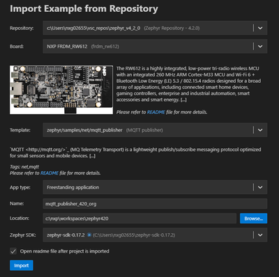

1. Use the “Import Example from Repository” tool from the MCUXpresso plug-in to import the mqtt_publisher example. It will open the README.rst file. It has a complete description of what the example does and how to run it with Ethernet.
