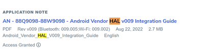

Hello @Abhijeet_Therokar ,
You can refter to the AN for 9098, and port your 8997 to android 11.
I don't have rights to upload files here.  if you have right to access wifi page, you can download it.
https://www.nxp.com/products/wireless/wi-fi-plus-bluetooth-plus-802-15-4/2-4-5-ghz-dual-band-2x2-wi-...
--->AN - 88Q9098-88W9098 - Android Vendor HAL v009 Integration Guide
--->Android_Vendor_HAL_M009.008_M009.013

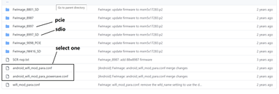

weidong_sun

2. firmware & wifi_mod_para.conf
According to your kernel version, download firmware. Assume you are using 5.10.72
https://github.com/nxp-imx/imx-firmware/tree/lf-5.10.72_2.2.0/nxp
