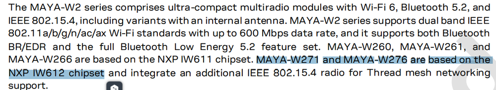

bgaurav1718
I am actually using the Evaluation Kit provided by UBlox. It is called EVK-MAYA-W2 based on MAYA-W276 which is again based on IW612 chipset.

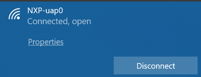

Christine_Li
Hi, @bgaurav1718
Thanks for your reply.
I suspect there are two reasons:
1. It is not necessary to set default gateway. I checked my ASUS router, there is also no gateway in the configurations which working as an AP. Please see below:
2. The configurations in  /etc/udhcpd.conf
opt router 192.168.2.1 # uap0 gw IP
It has influence on Internet access.
Christine.

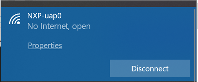

Christine_Li
Hi, @bgaurav1718
I think I have reproduced your issue on my local side with Linux kernel 6.1.22 and Wi-Fi driver is the default one in this kernel.
Please see below:
Right now I suspect it might be related to Linux kernel version.
I will try to debug and resolve it, once have any updates, I will let you know.
Christine.
