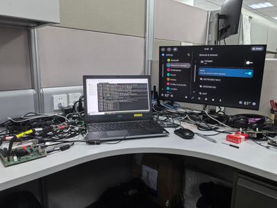

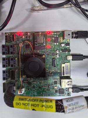

weidong_sun
Dear @swapnil ,
I tested demo image, the version is : Android Automotive 14.0.0_1.1.0 (LF_v6.1.55 BSP)​​​​​​
Don't need to do any change, only need to install AW-CM276MA to M.2 Key E connector on i.mx8qm-mek board, then burn android images into emmc on board.
See below screenshot, please!
weidong_sun_1-1728978203627.jpegweidong_sun_2-1728978225165.jpegweidong_sun_3-1728978241817.jpeg
checked firmware files in the vendor path, see below, please!
It means that the default bsp supports 88W8997 & 88Q9098 / 88W9098.
Thanks!
weidong

3,638 次查看
weidong_sun
Dear @swapnil ,
In default android auto bsp, WiFi/BT based on pcie9098 chip is supported, not PCIe8997.
From your logs, it seems there doesn't exist the firmware of 88W8997.
So firmware of 88W8997, pcieuart8997_combo_v4.bin should be needed. According to your linux kernel version, you can get firmware from the link, then push it to corresponding directory on board ( the directory should be /vendor/firmware/), anyway, the firmware of 8997 should be the same directory as that of PCIE9098 (its firmware name is: pcieuart9098_combo_v1.bin)
-- getting firmware of 88W8997(PCIE interface)
https://github.com/nxp-imx/imx-firmware/tree/lf-6.1.55_2.2.0/nxp/FwImage_8997
Try it, please!
Then tell me your test result.
Thanks!
weidong
3,528 次查看
swapnil
Thanks @weidong_sun for the efforts you put in. We too had tried BT/WiFi Chipset based on PCIe 8997 on this demo image. Seems there might be some issue with the chip we are using.
Thank you!!
