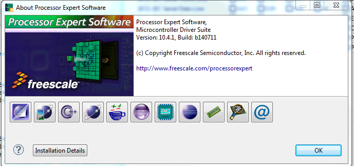

alejandrolozan1
I have the same behavior as Vilem.
The version I have is the next:
I wonder if there is any difference. I am not sure if there is an update package you need.
The installation details are the next:

alanball
Hi Alejandro & Vilem
Thanks for your reply :smileyhappy:
It looks like there is a later version of PE - I will check
In the meantime, since I was still able to change my hardware design, I changed from I2C0 to I2C1, which does not have any issue
