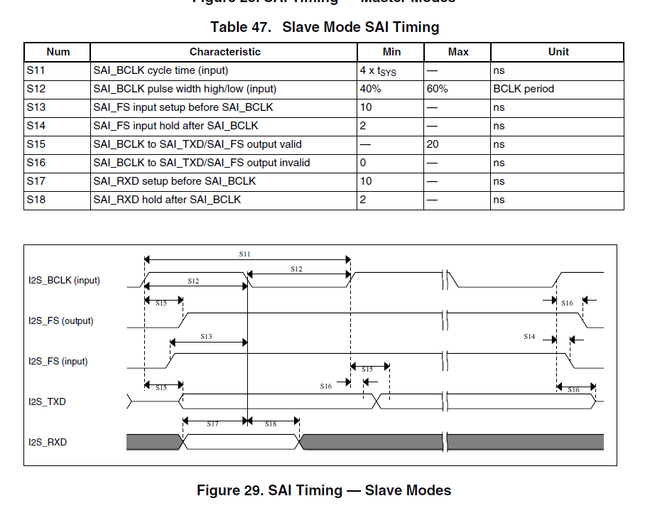

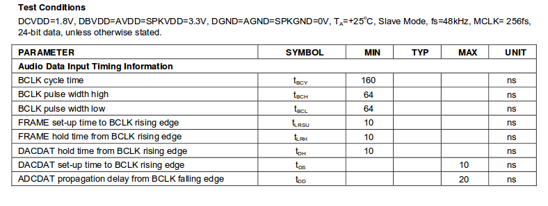

2,947 Views
timesyssupport
Senior Contributor II
Hi Juan,
              >Can you tell me which value has tsys?
According to the WM8974 wolfson audio codec document - ESAI (enhanced serial audio interface) clock cycle(Tssicc) = 30ns.
S12 is i2s_BCLK pulse width high (S11) and pulse width low (S11) - which is approximately 130ns.   Please refer the attached tabular column.
Timesys support.

fernandoalcaide
Dear,
In Document Number VYBRIDFSERIESEC appears S11 is 4*tsys. Can you tell me which value has tsys"?
