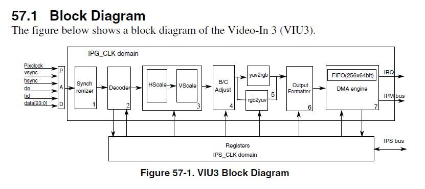

Hi, Vybrid expert:
the actual limitaion is ITU decoder, which can only output YUV422 or YUV444 (actually from YUV422).
so even we can input RGB888 and output RGB888, the quality will lost. right?
do we have anyway to do this without quality lost?
here is the information in our datasheet:
57.5.3 Decoder
The ITU Decoder block (2) detects the ITU656 timing reference signal (consists of a
four-word sequence in the following format: FF-00-00-XY) and extracts HSYNC,
VSYNC, field number signals and video data from the ITU data stream. The format of
active pixel data from the ITU stream is YUV 4:2:2. The decoder block can directly send
out this YUV 4:2:2 data, or interpolate it to YUV 4:4:4 format and send it out. This is
determined by the MODE444 field in the SCR register. This bit shall be set if the downscaler
is enabled, because the down-scaler works on YUV 4:4:4 data format.

VIU3 supports two ITU input modes, four RGB input modes and one parallel YUV input mode, see 57.3 Video Input Signal Mapping.  ITU decoder block is used for ITU input mode. No quality is lost, unless you tell VIU3 to convert RGB888 to different formats.

Blocks 2,3,4 and 5 can be transparent and make no effect.

could you please guide us how we transparent Block 2,3,4 and 5?
any registers confiuration for it?
2,684 次查看
kef2
Senior Contributor V
Skiping IOMUXC configuration, you need to set up just few registers like below. I have no hardware to verify RGB888 settings, hope it works.

but how to explain the following information: ( I think the ITU decoder has limitation no matter the input are RGB888 or others.)
The format of active pixel data from the ITU stream is YUV 4:2:2. The decoder block can directly send
