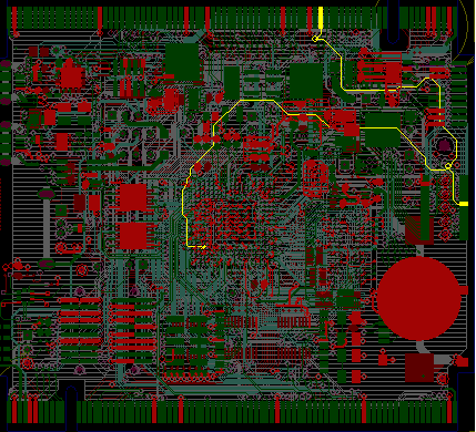

I have some weird I2C2 SCL clock issue. Please see attached oscillogram.
Digital chn 0 and analogue chn 1 is I2C2 SCL signal
Digital chn 1  - I2C2 SDA
Digital chn 2  - one of VIU3 pixel data inputs
Digital chn 3 -  VIU3 HSYNC input
Digital chn 5  - VIU3 PIXEL_CLK input
It seems SCL high pulse can be abandoned by VIU3 pixel data. No matter what's pixel clock, is it 10MHz or 40MHz, SCL still may get broken. I have 3rd party CMOS camera module attached to TVR-VF65GS10 card. This camera module for some reason passes SCL through integrating RC circuit with R=22 Ohm, C=680pF. That's why SCL rising edges are quite round. Issue persists even if I reduce SCL frequency to <10kHz (which I think should make rising time relatively short to be relevant). Luckily I have workaround for this problem, making SCL pin fully driven and not open drain solves the issue.
What's worse, once such short SCL pulse is generated, I2C module seems entering some weird state. For example sometimees I see bus busy in status register, though I2C and SCL both are idling high and MSSL=0.
Am I wrong in thinking that once I2C wins arbitration, nothing on SCL or SDA should be able to shorten SCL-high pulses. Isn't it? SCL-low can be stretched by slave device, but SCL-high shouldn't be affected, right?

richard_stulens
Hi Edward,
Thanks for the feedback. Looks like the camera is built to try to avoid cross coupling.
We have found through simulation that a glitch (or spike) can actually trigger the observed behavior. We are now investigating further.
If you ever see an opportunity to capture the rising edge of SCL for the error case, that would still be helpful as it will give us some data to match against.
Richard

richard_stulens
Hi Edward,
I had a look at the scope image that you attached earlier.
I don't think there is any clock stretching in that signal. We seem to be missing part of the clock pulse. Or prematurely done condition as you call it.
I'm wondering if maybe software incidentally re-programs the SCL clock timing, causing it to prematurely start a new clock cycle. This is inspired by the fact that it seems to correlate withH-Sync, independent of frequencies. Maybe Software wants to adjust timing to accommodate the VIU and in the process resets the SCK timing reference.
There's quite a bit of guesswork in this reply, but since there is very little chance that H-Sync can affect I2C in some hardware way, it's more likely software related.
Richard

richard_stulens
Hi Edward,
That's a good point. I did actually read that but I did not realize that it made things work correctly.
Now, that leads me to the following theory.
The I2C controller monitors SCL signal to detect any clock stretches by the slave. The detection of a rising edge on SCL starts the next cycle (bit).
Now, that detector may also trigger on glitches causing the controller to prematurely start the next cycle, which would result in a signal like the one you captured, The glitch can be introduced by capacitive coupling with some other signal.
If you are using wires for the I2C signals in the setup with the tower board, you may try using shielded wiring for I2C, or prevent glitches being picked-up in another way.
Also make sure both boards have a solid common ground point to avoid any ground noise.
I hope this will help to make it work correctly.

richard_stulens
Hi Edward,
Yes, clock stretching is supposed to lengthen the low-period of the SCL. it's also only supposed to be used for standard mode operation. However, I was not saying that this was some kind of clock stretching.
What I meant to say was that I think glitches on the SCL signal may cause the the transmitter state machine in the I2C controller  to prematurely start the next bit. I do not know the internals of this I2C controller so I do not know this for sure, but I have seen such things happen in the past on other devices.
The glitches that I refer to will be like spikes of a few 100 mV sitting on the rising edge of the clock, around the threshold level of the input buffer (at roughly 1.5V). They may only visible on a high-frequency scope.
If glitches are the problem, it may help to turn-on Hysteresis on the I/O pad.
Richard

richard_stulens
Hi Edward,
That should be OK.
I think we can conclude from your observations that the clock pulse can be shortened by external events.
Since the issue doesn't occur when the SCL pin is configured as output (no open drain) means that it must be caused by an external event as the only difference on-chip is the lower output impedance of the pin.
I'm fairly confident that you will not see this issue on the final PCB when traces will probably much shorter. On the current tower board, the SCL trace is uite long as can be seen below.
If you have not done so already, you could try to replace the 4.7K pull-up with a lower value (1.5K or even 470 Ohm), but I don't know if it will make much difference.
Thanks for reporting the issue. Let us know if there is anything else we can do to help.

richard_stulens
Hi Edward,
I have already requested design to lo check the I2C module to understand how exactly the pulse gets shortened. Based on that we will be able to judge what the next steps need to be..
In that respect, what is the frequency of the IP bus clock in your system?
It also occurred to me that you may be able to fix the problem by enabling the digital filter on the PTA22 input. I have never used this myself, but it should work if I understand things correctly.
The filter configuration is in the PORT module and PTA22 is on PORT0[12]. You can set the filter to use the bus clock. The filter length determines for how many continuous filter clock cycles  the input signal must be in the same state before the new state will propagate into Vybrid. I recon a filter delay of ~100 ns should be sufficient.

richard_stulens
Hi Edward,
Thanks for the feedback. I have passed on the frequencies to design. I hope to get a reply in the next few days,
For the digital filter, did you set the filter length (DFWR) before enabling the filter? The reference manual states that DFWR must only be changed when all filters are disabled. I do not know what the reason for that requirement is but it is easy to try if it was not already in that order.
For the marker, I never mark my own replies. Somtimes the community admins mark a reply as helpful.

richard_stulens
Hi Edward,
The design team is looking at the I2C module to understand where the issue may be.
Now the design engineer asks if you can try running the i2C at a much slower system clock, like  5 to 20 MHz and check if the problem still exists.
He also asked about lowering the pull-up resistance. Have you tried that already?
Is it possible for you to try the above?
I also had them check the input path and found that the digital filter on the PAD only works for GPIO, so that will help for the I2C input. (I have already marked the reference manual with this update).
Richard

richard_stulens
Hi Edward,
Thanks for testing. At this point we're trying to find an explanation for what we see happen.
My guess is that the video data creates a glitch on the SCL line. It is probably not a single data line, but a group of data lines all switching from low to high at the same time. For example video signal goes from black to white or so.
When the edges on the video data signals are very fast (dv/dt = high) this may cross-couple onto other signals.
Slow rising edges are particularly sensitive to this because the signal level will transition slowly through the threshold region. During that transition it may pick up this noise and this noise may look like a clock edge to the input. I.e. the clock input sees 2 clock edges instead of 1. It  will typically look like this:
Since you still see it occur at 20 MHz IPG clock, you may actually be able to see it on a 40 or 100 MHz scope as well.
Richard
