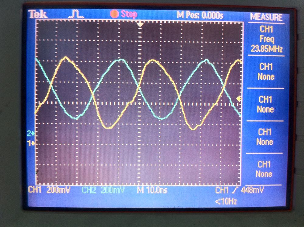

I am trying to have our VF3x to reset and accept the 0x23454523 command from the serial channel and transmit back to the terminal.
I measured:
  • 3.25 Volt on VBAT pin
  • 3.3 Volt on VDD_LDOIN ( about 100 milihundred volt noise)
  • 1.13 Volt on DCAP_V11_LDO_OUT
  • 2.52 Volt on DCAP_V25_LDO_OUT
  • 3.3 Volt on VDD33
  • 3.3 Volt on VDDREG
  • 1.2 Volt on VDD
  • 5.2 Volt on USB_VBUS
  • 3.1 Volt on USB_DCAP
  • 1.8 Volt on VBCTRL
23.99 MHz on XTAL-EXTAL pins ( XTAL pin has perfect sine wave, while EXTAL pin has a periodic signal between sine wave and triangle wave)
There are a 2.2 MOhm parallel resistor in ref design for XTAL pins' series capacitor. Why it is used?
The PCB draws 86 mAmperes from 3.3 Volt supply.
My RCON Mappings are adjusted for serial boot loader from UART 0. But I could not get answer to 0x23454523 message.
Do these voltage values and osc. value proof that chip has reset?
What else I could check?

3.    Regarding the XTAL-EXTAL pins - may I see the oscilloscope screenshots, please?
4. Regarding the 2.2 MOhm resistor - mentioned i the Errata (http://cache.freescale.com/files/32bit/doc/errata/VYBRID_1N02G.pdf?fsrch=1&WT_TYPE=Errata&WT_VENDOR=...):
  • e7128: XTAL: In some cases the 24MHz oscillator start-up is slow.
  • Workaround: A 2.2 MΩ resistor from XTAL to ground will make the startup times reasonable.

3. blue line is for XTAL. I noticed that the voltage level (600 mVolt) is below then the requirement (Vdd*0.75= 825 mVolt), and re-measured the voltages with another calibrated oscilloscope as 850 mVolts and 888 mVolts. So the voltage levels are in the acceptable range. I am not using the exact crystal in the reference design, instead, I am using NX3225SA-24.000000MHZ which was for i.mx258 ref. design
4. If it does not stop the processor reset/boot, I don't care the slow start-up at the moment, but I also added 1 MOhms, but could not bootloader to start.
