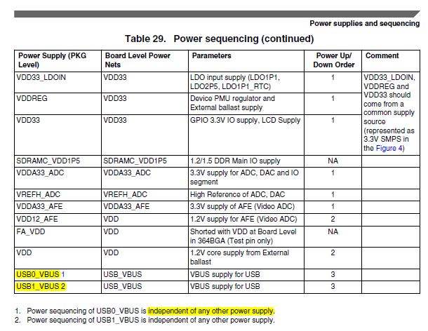

Dear Sir,
In the Vybrid datasheet's Power sequencing section it is given that USB_VBUS can be independent of any other power supply.
Can we provide 5V to USB#_VBUS before providing all the other power supply?
Waiting for your valuable replay.
Thank you in Advance.

Hi Shameem,
  Yes, you can provide VBUS before the other power supplies. That was a former requirement on 1.0 silicon, but is no longer true on 1.1 (current production) silicon. The datasheet will be updated to reflect this.
-Anthony
