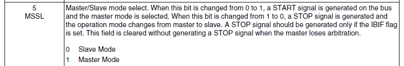

I use master mode in i2c0.
In the case of I2C0_IBCR[MDIS] = 1, I can set I2C0_IBCR[MSSL] =1 .
And, In the case of I2C0_IBCR[MDIS] = 0, I can not set I2C0_IBCR[MSSL] =1 .
I ask about this problem matter.
Q1)
Is I2C0_IBCR[MDIS] = 0 enable of I2C0 ?
Q2)
Is this specifications of this I2C module?
Q3)
In the case of I2C0_IBCR[MDIS] = 0,What should I2C0_IBCR[MSSL] = 1 do to set it?

jiri-b36968
Hi Soichi,
Q1. Yes MDIS = 0 make I2C module enabled: see RM
Q2.
Setting of any bit has no effect if module is in SW reset state (MDIS == 1). You can set it but it become valid after module is enabled (MDIS == 0).
Q3. see RM:
/Jiri
