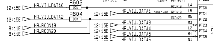

We connected a analog camera to an external video-decoder (adv7180) which is connected to the viu using the 8bit itu656-interface (Vybrid VF512R3CMK4).
When we start the video-decoder it sends out the serial protocol, and we can see correctly the protocol (SAV/EAV starting with FF 00 00 XX, where XX has different state for field/vsync/hsync, ...)
The VIU detects field-irqs, but we don't get any vsync-irq.
Although we don't get any error-irqs, so it seams that the received protocol is correct (see ecc-errors in scr-register of viu), but the internal decoder from the viu-module doesn't generate a vsync-irq.
Has anybody use the viu using the 8bit itu656-mode ??

jiri-b36968
Hi Sebastian,
we have checked all lines. If there are correctly connected to Vybrid: there is an issue on the board:
between External ADC and VIU data 2 is 10k resistor:
Measurement1:
Yellow is Analog
Red line is D2 (HR_VIU_DATA2) - before resitor
Green is clk
Light blue are D9 to D2
Red line is D2 (PTC2) - after resistor
So signal on D2 is not correctly connected.

We removed R604 and placed 0R - situation has changed significantly. signal on PTC2 is correct.

jiri-b36968
Hi Sebastian,
I'm afraid that HSYNC_IRQ and VSYNC_IRQ interrupts as raised only when VSYNC and HSYNC signals are used (need to be confirmed with designers). ITU is using just fields (FIELD_IRQ) and VSYNC and VSYNC are decoded.
Please try to use DMA_END_IRQ (VSTART_IRQ). Do you see them raising?
/Jiri
10,106 次查看
slw
Hi Jiri,
as explained above, I only get the FIELD_IRQ. When I start the DMA-Transfer I never get an DMA_END_IRQ and DMA_ACT stays busy.
Is it even possible to use the ITU-mode without external HSYNC/VSYNC-signals connected ?

Hi Sebastian,
tested alignment on your board. Added pin output debug in VIU ISR.
So far: Field interrupt is not correctly aligned with start or end of the frame:
triggered at start of interrupt routine (peak at CH3 and 4 - trigger). Delay between start of frame and interrupt routine vary from about 300us to 6ms.
Decoding is not correct.
what is interesting it that interrupt comes always at same moment withing a line - in the middle of the line (probably latency). So we can say that it is between lines but not between correct lines:
ISR is alligned to HS from External ADC:
Ch4 is interrupt service routine, Ch3 is HS from external ADC
So wrong setting of Vybrid decoder, wrong setting of External decoder or wrong connection are valid reasons,..
/Jiri

jiri-b36968
Hi Sebastian,
Measurement1:
Yellow is Analog
Green is clk

Error 7 is not enough lines
Error 5 is too many lines.
All interrupts are generated .
So now you have to change setting of the interface.
/Jiri
10,100 次查看
slw
Hi Jiri,
That's it.
We have modified our driver and now we have a live-video-stream.
Thanks for your help !
Sebastian
