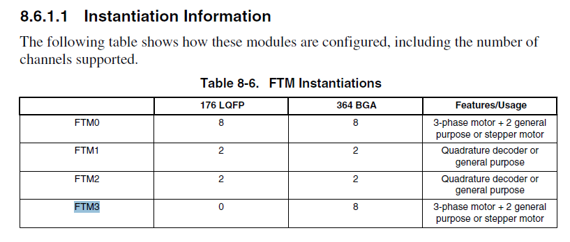

For the FTM:
Then you can have up to 20 FTM channels depending on the package.  In case they are not enough you can always use the PIT to trigger DMA transfers and change GPIO pin state.
