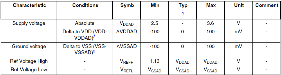

jiri-b36968
Hello Tomoki,
it looks like that your issue is happening on pins which could be used as ADC inputs only. This is related to not powering ADC.
You are pointing to information in datasheet:
but there is also:
So content is king of inconsistent. The reason is probably ESD protection diodes. Working on that with designers and will let you know.
Please try to power ADC pins and not enable ADC from your application for now.
/Jiri

jiri-b36968
Dear Tomoki san,
ESD protection is on every pin before any multiplexer. It is usually between Ground and VDD(A, IO-RING) or . It is protecting pin itself.
There is not any open drain input, but open drain output. If you want to use it as input in the same time you need to write to output buffer logical 1 GPIOx_PDOR (PTA17 equals to GPIO0[7] ). In that case output transistor will be closed and on the pin will be logical 1. You can tight it to the ground externally and monitor state of the pin in GPIOx_PDIR.
Your setting look like that you have not enabled OBE and ODE in the same time.
Generaly it is strange to tight VDDA to the groung if ADC unused because in Table 31 in Datasheet is mentioned:
delta VDD to VDDAD should be beween -100 and 100 mV.
/Jiri

naoumgitnik
Senior Contributor V
Hello Jiri,
Regarding connections of the VDDA power rails, I see the following logic in the Datasheet, which differentiates between 2 conditions, i.e. operating and unused:
  1. Delta between analog VDDA and relevant digital VDD of -100 to 100 mV in the "12-bit ADC Operating Conditions" table,
  2. Connecting to GND in the "Recommended Connections for Unused Analog Interfaces" table.
Regards, Naoum Gitnik.
