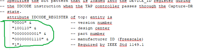

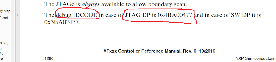

I made a boundaryscan project for a board with a Vybrid module MVF50NS151CMK40 using the "Cascon" tools from Göpel electronic.
I have a bad answer when I read the ID register:
Cascon tools reads 0100 1011101000000000 01000111011 1 (4BA00477).
Value expected (see BSDL): 0001 1001100000000000 00000001110 1 (1A80001D).
The value reads (4BA00477) is the "debug ID code from the JTAG DP port" (see sheet 1286 of the VFXXX controller reference manual).
So, I understand that the Vybrid is in debug mode, not in test mode (JTAG 1149.1).
In the BSDL (VYBRID_364_F.bsdl), there is no compliant pattern or design warning.
Is there a special configuration to work with the "test" tap port, based on IEEE1149.1 specification ?

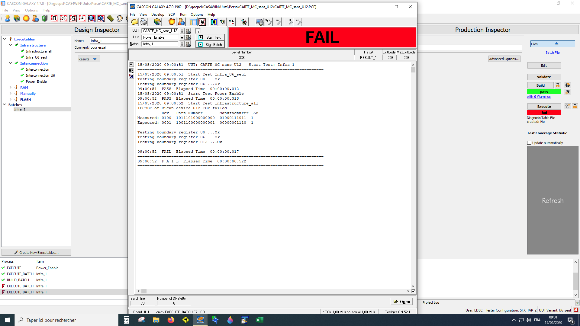

The picture is too small for me to see the details but you mention :
"-Load IR (Instruction Register) with IDCODE opcode."
According to Table 9-19 in Reference Manual the IDCODE for
JTAGC should 4'b0000 (as opposed to 4'b1110 for ARM DAP).
Perhaps you can verify what IDCODE is being sent by the tool
are using.

luc410
Hi Sinan,
The IDCODE "opcode" sent by the tool is 4'b0000, the tool use informations from the bsdl file.
Sorry for the picture, I put a new one:
I don't understand why I am in the ARM DAP, I should be in the JTAG TAP : perhaps a bad hardware configuration, but I did not find
any information on this subject.
Thanks for your help.
Luc

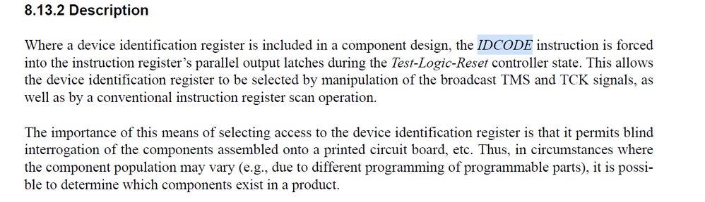

The goal of this test is not only to check the IDCODE, but to communicate with the
boudary scan register to read/write external I/O (not  chek internal functions of the SOC).
Checking the ID code validates the jtag chain (the right component in the right place) and after the testor go to the next step who is "interconnections test" to chek connections between boundary scan devices.
I did this test, and I got anything as a result.
My understanding is that I am not communicating with the right jtag chain, but I do not understand why.
Normally, if the component complies with standard 1149.1, the IDCODE register of the bsdl should be accessible through the jtag bus, without the need to write in the instruction register (see below):
if the component is not in phase with this procedure, this must be specified in the bsdl (compliant pattern or design warning), but, at this time, I don't find these informations.
I do not have a logic analyzer, but I think it is possible to visualize with the tester the TCK / TMS / TDI / TDO signals. I will send you the captures if it works.
Luc

luc410
Hi Sinan,
Using the analyzer of the tool,I realized that the tester came directly to read the IDCODE without sending the instruction before: it is an error on my part, it is possible to preload the instruction register before reading the IDCODE. I made the correction and it's now ok. I apologize for the inconvenience.
Many thanks for your help.
Luc

Hi Yuri,
I already read this thread : this is not the same issue, in my case I can't read the "good" ID-CODE in infrastucture test.
I wan't to read this ID-CODE (extract from  "VYBRID_364_F.bsdl" file):
In fact I read this one (extract from "VFXXXRM.pdf" VFXXX Controller Reference Manual):
Regards.
Luc

luc410
Hi Yuri,
Here is the log:
There are two jtag chain, one with U0 + U6, and another with U12 (Vybrid).
U12 power are controlled by U0+U6, so the sequence is the follow:
Test infrastructure U0+U6.
Turn on Vybrid power (U0+U6).
Test infrastructure all (U0+U6 on chain 1, U12 on chain 2).
For the infrastructure test, for the three devices, the process is alway the same.
-Scan IDCODE register (32 bits) and compare with the IDCODE of the bsdl file.
The IDCODE is ok for U0 and U6, but fail on U12 (Vybrid).
Luc
