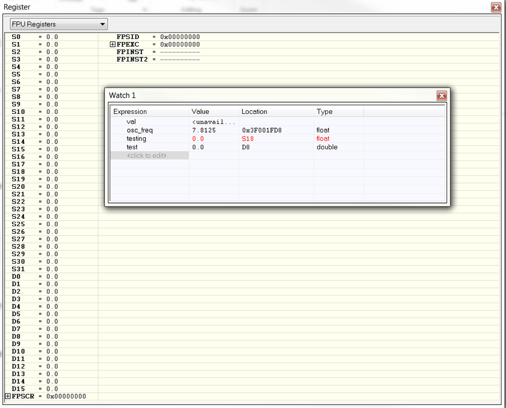

I'm debugging code written for the Freescale VF6xx_A5, using IAR's EWARM 6.50, and am having an issue with floating point numbers. When I try to assign a non-zero value to a float, the float is automatically assigned a value of zero. For example, test and dac_vref in the code below are set to zero when the debugger steps through those lines.
  double test = 30;
  float dac_vref = 3.3; //3.3 V reference
I've tried messing around with the library configuration options both when writing the program inside and outside MQX 4.0.2, but enabling the full library (vs "normal") options hasn't helped.
Thanks.

n00b1024
Cool, thanks!
I've had this problem writing straight to the stack (IAR Systems\Embedded Workbench 6.5\arm\examples\Freescale\VF6xx\TWR-VF600\src\projects\getting_started) as well as with example projects in MQX 4.0.2. Recently, I've been working without MQX. It doesn't seem to make a difference either way.
All of the FPU registers are showing up as 0.0, and they're all initialized to that value when the program gets to main. In the image below (no MQX), I've just finished stepping through the following three lines inside main (osc_freq being a global variable):
  double test = 3.5;
  osc_freq = 7.8125;
  float testing = 3.45;

n00b1024
Thanks for all your help, Juan! The problem was the (rather old) JTAG.

n00b1024
Hi Mike,
Sorry for not getting back to you earlier -- I was out of the office yesterday. I was using a J-link v6 (from 2007) with IAR EWARM 6.50, which was causing the problem. If I use a JTAGjet-Trace-4M, I don't have the problem with the floats.

n00b1024
Hi Juan,
Thanks for the advice. I tried the command-line code, but ran into a compiler error because I'd previously defined the FPU as VFPv4 + NEON and the device as Freescale VF6xx_A5 (as was shown by the image you sent), inside the General Options -> Target of the Project Options.
Using those options, I still see dac_vref and test being assigned to FPU registers ($S16 and $D8) with values of 0.0. However, the interesting thing is that if I declare a float as a global variable, then its value gets stored in OCRAM. I can assign that float a non-zero decimal value either outside a function or inside a function, and the float value will be properly assigned to the variable. However, if I try to declare a float as a local variable, then value is stored inside an FPU register (e.g. S16) and is automatically set to 0.0. I've been checking the values of variables using Watch, have compiler optimization set to none, and have no linker optimization options selected, so I don't think that optimization is deleting those debugging variables.
5,344 Views
