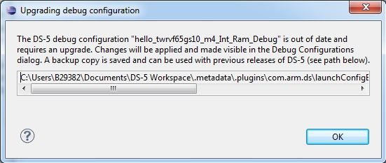

I had tested the twrvf65gs10 sample code like as "hello" using Eclipse for DS-5.
I had followed the sequences on "MQX-DS5-Getting-Started.pdf"
But I had met the problem on section "3.1 Debugging Primary Core - MQX Hello World program"

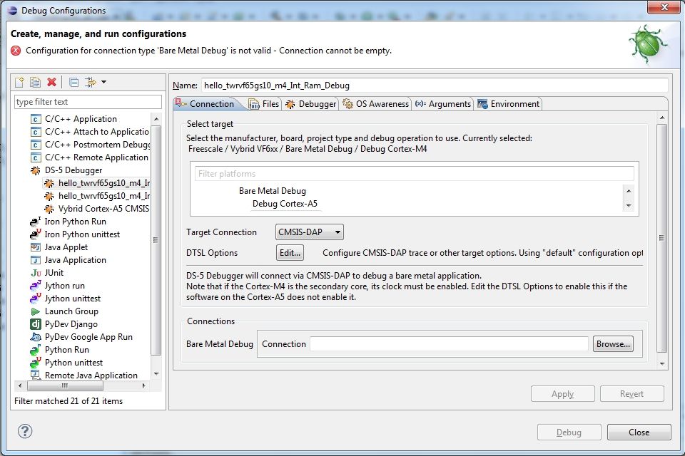

Even though compile was success, I met the pop-up window like as below image when select the "Debug Configurations..." -> "DS-5 Debugger" -> "hello_twrvf65gs10_a5_Int_Ram_Debug".
After that, "Debug" button does not enabled like as below.
Even though I had tried to find out the solution for this, still I can't find out it.
If anyone know the solution for this behavior, could you give me the advise or solution for this?

Dear Lee,
You should first install the openSDA USB device driver into Windows, and copy  CIMSYS-DAP.S19 file into the openSDA disk drive as explained "Vybrid OpenSDA Lab" document. Then you will see "A000000001:Keil Software OpenSDA CMSIS-DAP" message at the connection window, then you will select the file to download.
