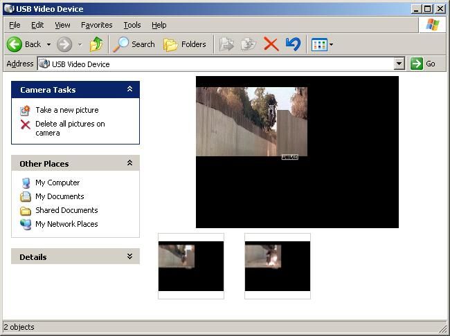

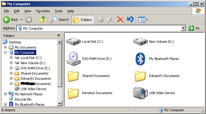

WinXP supports USB UVC cameras in Windows Explorer, where you can watch video and take screenshots from camera. See below.
I've just found one problem with FSL USB stack. I was fighting some artifacts watching video. I decided to reduce frame rate, which could help finding max frame rate or shed some light on problem. Reading UVC class specs, I figured that video frame rate is (or should be) controlled changing data packet size, which is send every millisecond over isochronous endpoint in full speed mode. I was trying to lower packet size, but frame rate was changing minimallyin uncontrolled manner until minimum packet size of 36bytes. Probably it is some special number, but no packets are send if I further lower packet size, but video frame rate was still about 20-30fps!Camera demo uses USB_App_Callback() to prepare buffer and send USB packet on USB_APP_SEND_COMPLETE event. And that was the problem. As a workaround for now I synced packed prepare and send to microframe counter period (each 8 microframes). Works well, but certainly this is not a right approach. Looks like stack should be modified to support isochronous transfers in high speed mode. Perhaps MQX USB supports it already, but it doesn't support UVC class.
