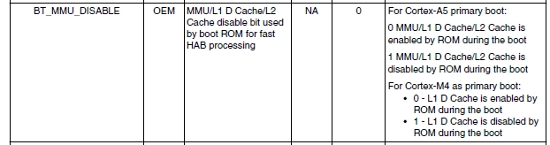

Hello Takahashi-san,
Do you need to know how to handle RCON22 and RMII1_MDIO pins when RMII1 is not used?
If yes then:
RCON22 pin (PTB27) is not related to RMII1. Maybe they use it is interrupt input.
PTB27 pin is set to RCON22 (mux mode 0b011) on reset -> BOOT_CFG3[6]. Which is BT_MMU_DISABLE. We use pull down so MMU is enabled.
Pin PTC0 is set to GPIO by reset. It can be set to RMII1_MDIO in IOMUX. Pin is set as input without pull-up. If RMII1 is not used then pull is not necessary.
