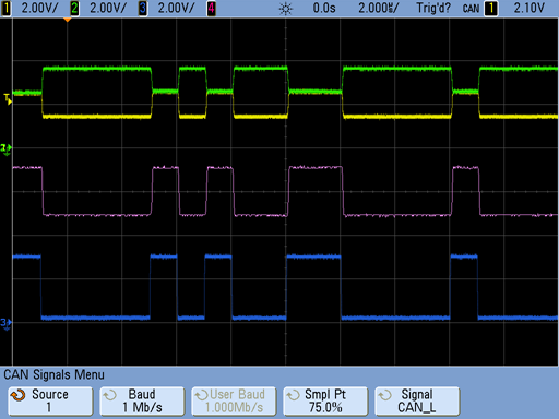

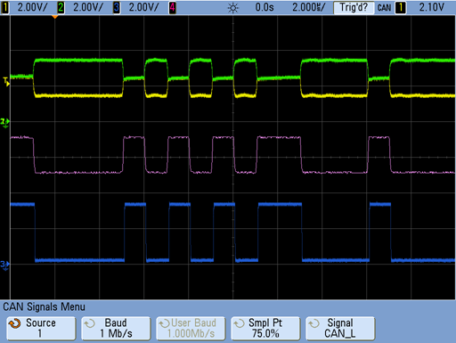

Signals should look like this:
TX signal rising edge have to be sharp - because of it - RX is much longer than supposed to be.
CAN Transmit 1Mb/s zoom, Channels:  1 CAN_L, 2 CAN_H, Math 2-1, 3 TXD
CAN Receive 1Mb/s zoom, Channels:  1 CAN_L, 2 CAN_H, Math 2-1, 3 RXD
#2 every massage on CAN have to be acknowledged. message is corrupted (#1) moreover some device have to be connected.

Some missed informations about images:
     CH1 - RXD signal (between the transceiver and the CPU)
     CH2 - TXD signal (between the transceiver and the CPU)
