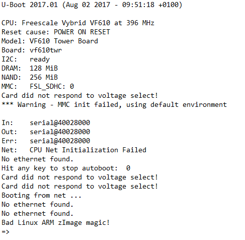

I then downloaded the latest version of u-boot from the Denx website, and was able to successfully compile it. However, this version of u-boot does not have USB functionality enabled by default. When I try and load u-boot using the MFG Tool, I get the following serial debug info:
I know that u-boot can be configured using the 'make menuconfig' command. I would like to know what Symbols must be set in order to enable the USB Download gadget, to allow me to program the QSPI flash using the MFG Tool.
