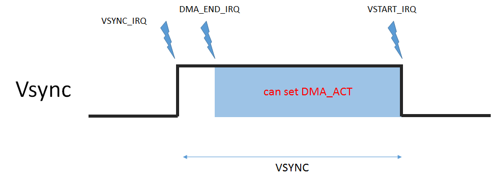

Hi community.
As RM explains that DMA_ACT should be set during VSYNC period.
My understanding is that VSYNC_IRQ is set at start point of VSYNC and VSTART_IRQ is set at end of VSYNC.
I guess DMA_END_IRQ is set within VSYNC.
So My understanding is that DMA_ACT can set between DMA_END_IRQ and VSTART. Could you confirm it ?
This is HW question, so please include HW team, too.
