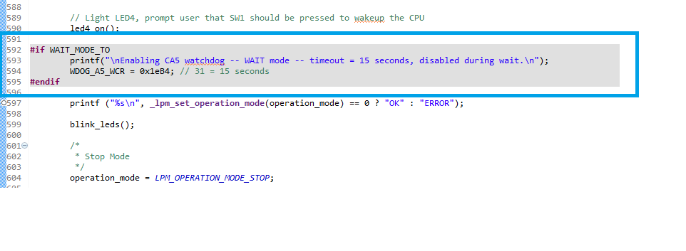

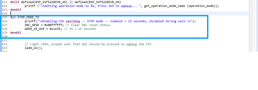

I do not have a diff for my changes, but it is real easy. Below are screen dumps. The file to change is power_mode.c
To disable WD for wait mode:wait_mode.png
To disable for stop mode:

Now, I did my own quick test. I used the low-power demo from MQX4.2. This demo cycles to all different power modes.
When I set the WDW bit, just before the chip is placed into wait mode, then there is no reset. I have the timeout set to 15 seconds and wait for more than one minute. When I press the wakeup button (part of the demo code), the code continues as normal, but since the code does not service the watchdog, the watchdog resets the part after 15 seconds. This proves that the watchdog was initialized.
The same works also for stop mode and the WDZST bit set in the WDOG_WCR register.
You have to make absolutely sure that the WDOG_WCR register is written only once. Any further writes will be ignored. For example, if the watchdog was initialized during startup without the disable flags set, then the flags cannot be set anymore. So, check if the flags are on after setting them. Also make sure the device is actually in the wait or stop mode and did not incidentally exit wait/stop mode.
