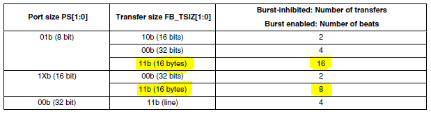

We are having an issue with burst transfers on the Flexbus.  We would like to transfer four 32 bit double words per burst.  This is necessary to obtain the data throughput we need in our system.  The reference manual does not show any specific timing diagrams for this type of transfer, but it does state in a table in section 32.4.12.2 that a port size of 32 bits can burst with 4 beats.  Discussions with local FAEs suggest that this should work as we understand it.
I’ve defined chip select 2 for write burst accesses in our system.  To that end, the chip select has been programmed as follows:
Register    Value      Description
FB_CSAR2    0x30020000  Sets the base address of the chip select to 0x30020000.
FB_CSCR2    0x00000108  No wait states, Burst writes enabled, auto terminated accesses
FB_CSMR2    0x00000001  Enables the chip select for range 0x30020000 to 0x3002FFFF, write are allowed.

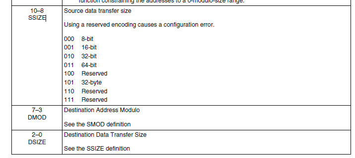

Additionally, we’ve set up a DMA to move multiple 32 bit double words out the port.  When the DMA destination data transfer size is 32-bit, only single Flexbus accesses are observed.  Does the DMA destination data transfer size need to be 32-byte to support bursting on the Flexbus?  When we set the DMA destination data transfer size to 32-byte the DMA stalls and no transfers on the bus are observed.  How does the DMA need to be configured to allow the Flexbus to transfer four 32-bit double words per burst?

Hi John,
please sent me some waveform including /FB_TBST and FB_TSIZs for 32 byte transfer with Flexbus burst enabled and disabled.
and
please try 64 bit DMA transfer ( hopefully you will see a burst with 2 beats) please send me and waveforms including /FB_TBST and FB_TSIZs also.
I need to discuss it with designer so I need those materials.
/Jiri

jiri-b36968
Hi John,
Finally I have confirmation from designers: Burst transfer between DMA and Flexbus is not possible. DMA is 64bit AHB bus master. Flexbus is 32bit data width AMBA AHB bus slave. The problem is the AMBA AHB 64bit width to AMBA AHB 32bit width bus converter on Vybrid can not convert input bursts with a data width of 64bits to output bursts with a data width of 32bits. Because of this, all requests that reach the FlexBus are single beat operations. Sorry for that.
The burst between Flexbus and the target memory is something else - it is are working when 8b or 16bit target memory port wide is used.
/Jiri

Hi John,
I see, so in this case we talking about 32 bit line transfer (last line in the table). Flexbus itself should be able to transfer four 32-bit words in one line (or burst if you like).
Is /FB_TBST == 0 which is indicating burst transfer? I'm hesitating if it is possible, that you feed Flexbus with data too slow. What is the distance between each transfer of mentioned 64 single 32-bit word transfers? Could you send me some waveform including /FB_TBST and FB_TSIZs?
The data has to be transferred to Flexbus driver fast enough (from DMA or cache) - so it require burst from DMA to Flexbus. DMA can send data in burst only in selected data sizes for example 32bytes. see DSIZE in the table:
Not sure it will work since DMA uses 32 bytes and Flexbus 16 bytes - need to discuss it with designer if it will not work for you. So let me know it that helps.
/Jiri

We have been using the DMA to transfer 32 bit words for a couple of weeks now.  With the DMA, we get the single beat transfers back to back (no delay between the accesses).
The FB_TBST is being used at an nOE, but we could probably repurpose it temporarily.  The SIZ bits are being used as GPIO for other purposes.  We could probably look at those too.
8,307 Views
johnfielden
Opps, I meant to say, yes, we have setup the DMA to send 32 bytes to the flexbus.  What we see are 8 single beat 32 bit transfers.  Each transfer looks like a normal non-burst transfer with a total of 4 clocks (Address, data, with two clocks of buffer).  With the DMA there are no additional clocks between each of the 8 transfers.  Just not a 4 beat burst.

jiri-b36968
Hi John,
Table 32.4.12.2 describes bursting between Flexbus and external device depending of port size of the device. So when you have 32-bit data you can transfer them in 4 burst cycles when port size is 8-bit wide.
Transfer between DMA and Flexbus driver is something else. Flexbus driver is NIC slave. DMA is master on NIC. This transfer can be also burst-ed. When you transfer 32 bytes you can transfer them in 4 cycles since interface is 64-bit wide.
But I guess you are talking about burst transfer between Flexbus driver and external device.
/Jiri

jiri-b36968
Hi John,
OK so burst between Flexbus and your external device is not working for you. Your setting of FB_CSCR2 is: 0x00000108 which is BSTW=1 bus write enable, AA=1 auto acknowledge enabled, PS=00 32bit size.
Your data are 32 bit and you write to 32 bit wide port size. So bust write is finished in one cycle.
/Jiri

jiri-b36968
Hi John,
yes John, the burst will be used when you transfer 32 bits through 8 bits wide bus (4 beats) or 32 bits through 16 bits wide port size (2 beats), but not for 32 bits through 32 bits wide bus. So it seems that burst between Flexbus and external device works for you.
Anyway you can extend your burst transfer to 16 bytes, but only for 8bits or 16 bits port size (you have set it to 32 bits)
So please change port size to 16 or 8 bits port size and then try your transfer. You can check burst length on FB_TSIZ lines.
