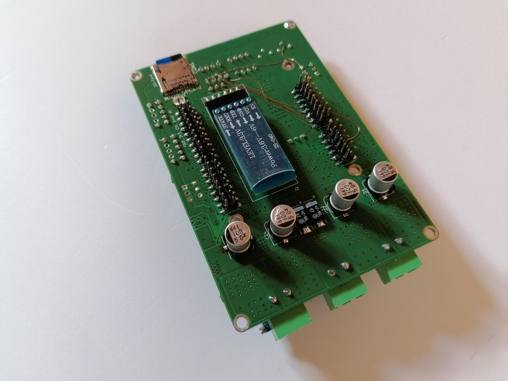

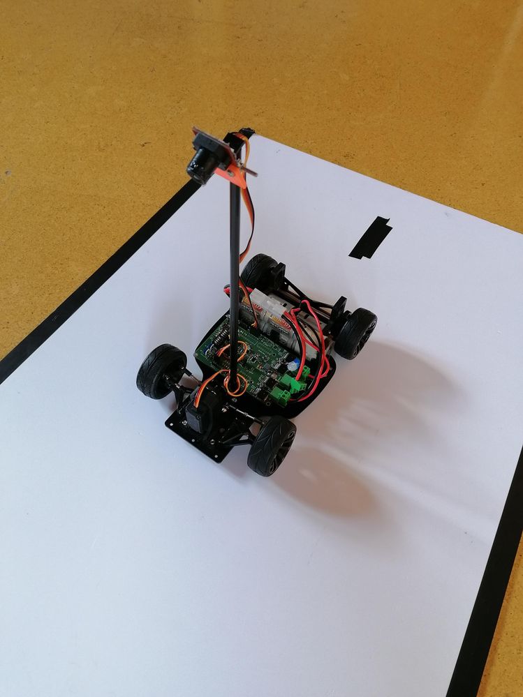

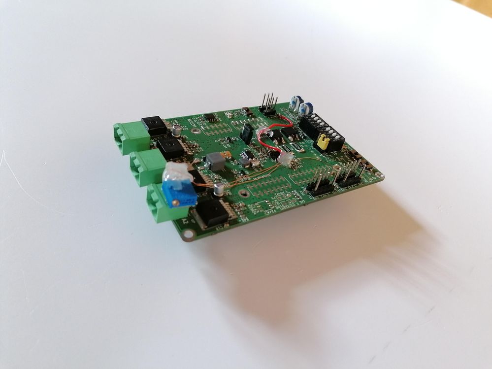

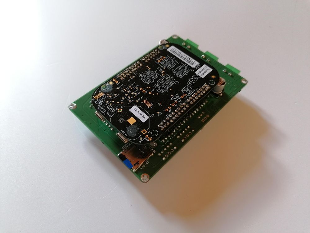

During the last weeks we assembled the very first prototype and tested it on an Alamak car with the FRDM-KL25Z:
![IMG_20200711_171342.jpg IMG_20200711_171342.jpg](/t5/image/serverpage/image-id/115603i61B98DD2B9D48524/image-size/large?v=v2&px=999)
![IMG_20200711_170757.jpg IMG_20200711_170757.jpg](/t5/image/serverpage/image-id/115595i67D58EFDD668D9A4/image-size/large?v=v2&px=999)
![IMG_20200711_170848.jpg IMG_20200711_170848.jpg](/t5/image/serverpage/image-id/115594i2BE431C159D15D74/image-size/large?v=v2&px=999)
![IMG_20200711_170908.jpg IMG_20200711_170908.jpg](/t5/image/serverpage/image-id/115591iD6DEBCA2F1F1E13E/image-size/large?v=v2&px=999)
We had some smaller issues that could be solved with some jumper wires :smileyconfused:, but after all everything seems to work reasonably well :smileywink:.
Next week we will order the redesigned version and also publish the KiCad project and other documentation on GitHub.
You can already view the schematics attached to this post.
