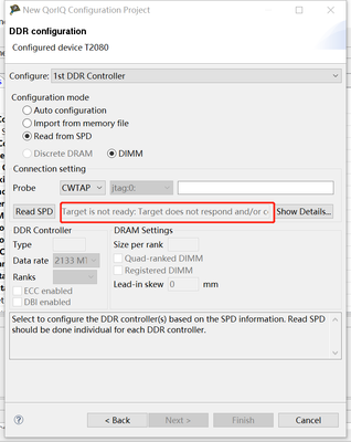

T2080rdb, I need DDR Validation, but I can't connect the target, because I don't know how to fill in the
CWTAP ID.

i  use the CodeWarrior TAP USB connection,I tried to read the parameters from SPD, but the following
error occurred:
Target is not ready: Target does not respond and/or could not be reset

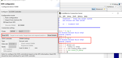

yipingwang
There is no problem with the basic connection between CodeWarrior and the target board.
When you click "Read SPD", CCS(CodeWarrior Connection Server) will be popped up at the right bottom of the Window task bar, please open CCS console and type "log v", then click "Read SPD" again, the low level CCS log will be printed out in the CCS console. Would you please capture this CCS log to me to do more investigation.

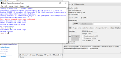

muaxi8
Contributor V
there is  no  output

yipingwang
Please close CodeWarrior IDE and all CCS consoles.
Please open CodeWarrior IDE in a new workspace, then create a QCVS DDR project.
Please click "Read SPD", CCS(CodeWarrior Connection Server) will be popped up at the right bottom of the Window task bar, please open CCS console and type "log v", then click "Read SPD" again, the low level CCS log will be printed out in the CCS console automatically.
Would you please capture this CCS log to me to do more investigation?

muaxi8
Contributor V
 I closed CodeWarrior IDE and all CCS consoles;
I open CodeWarrior IDE in a new workspace, then create a QCVS DDR project.
I clicked "Read SPD", CCS popped up at the right bottom of the Window task bar,  i opened CCS console and type "log v", then click "Read SPD" again, but there is nothing in ccs. my god

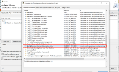

Did you install QorIQ Configuration and Validation Suite 4.5.0.0001-20160210?
You could get the version information from Help->Install New Software->already installed.
Or please try to uninstall QCVS tool and reinstall it again, please don't plug in CodeWarrior TAP when installing the software.

codewarrior version is 10.5
i  have  installed QorIQ Configuration and Validation Suite 4.5.0.0001-20160210 .
