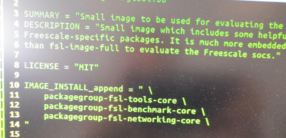

Hi guys,
I am working with the board T2080RDB. I am using the operative system which is provided by NXP using Yocto Project and the sdk 2.0-1703.
The size of fsl-image-core-t2080rdb-64b.rootfs.ext2.gz.u-boot is 32M previously.But now it becomes 62M. I don't know why it happens.The reserved space is 44M and isn't enough in the NOR flash(boot flash).
The fsl-image-core.bb file is below:
I run bitbake fsl-image-core many times, but the size of fsl-image-core-t2080rdb-64b.rootfs.ext2.gz.u-boot is 62M all the time.
How could I change the size of fsl-image-core-t2080rdb-64b.rootfs.ext2.gz.u-boot  from 62M to 32M?In other words,how could I decrease the size of fsl-image-core-t2080rdb-64b.rootfs.ext2.gz.u-boot?
If any body has any lead over here so pls help me. suggestions would be highly appreciated.
Thank you.

Hello andress jackson,
I have install SDK 2.0 1703 release and build fsl-image-core-t2080rdb.ext2.gz.u-boot, it's about 32M.
Please refer to the attached fsl-image-core.bb to check whether you have added additional packages in IMAGE_INSTALL variable.
Yiping

andressjackson
According to your suggestion, I solved the problem.
Thank you a lot.yipingwang
