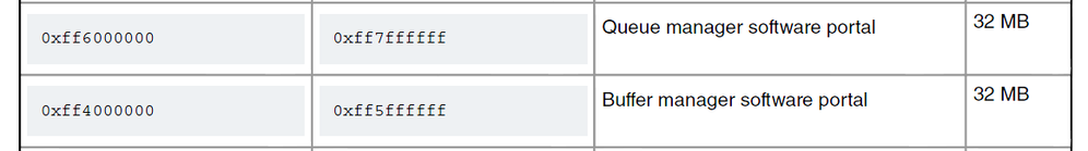

I resolved the problem by setting
fqd_a
(qman_fqd in dts) address in file Path_To_SDK/QorIQ-SDK-V2.0-20160527-yocto/build_t1042d4rdb/tmp/work-shared/t1042d4rdb/kernel-source/drivers/staging/fsl_qbman/qman_config.c to 0xff6000000 according to QorIQ-SDK2.0 document page 267:
and now qbman and ethernet drivers are initialized and fm1-gb0..4 interfaces can be seen by ifconfig -a (I attached boot and ifconfig log). however I have some problems when I set IP or ping and I asked my problem in another question, thank you for your help :smileyhappy:.
My questions now:
1) is that address the correct one? and should I also set bman_fbpr ,qman_pfdr ,pme_pdsr and pme_sre addresses to some locations in above address map or their must be the default value in dts?
2) I changed address of qman_fqd by setting it in the parser function in qman_config.c driver file, How can I change it through reserved-memory in dts? I change alloc-ranges property to some other value e.g.:
alloc-ranges = <0 0 0x2200000 0x55D4A80>;
but the address does not change.

Hello mohsen haghighat,
It seems that you didn't configure BMAN in your Kernel configuration, please refer to the attached Kernel configuration.
You could run the following commands in Kernel source folder to generate .config automatically.
$ cp arch/powerpc/configs/corenet32_fmanv3l_smp_defconfig .config
$ make ARCH=powerpc menuconfig
Then save the configuration as .config file.
