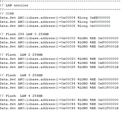

I am trying to have basic baremetal code run on T2080RDB. I have set the LAWs as shown in below screenshot . whenever I am trying to execute store instruction the program counter is going to default handler.
could anyone help me with this issue?

Can you share what software version are you using and your process when setting the LAWS?,
Once a local access window is enabled, it should not be modified while any device in the system may be using the window, it is important to understand and read the chapters in the RM:
2.3.2 Configuring Local Access Windows
2.3.3 Distinguishing Local Access Windows from Other Mapping
Functions
