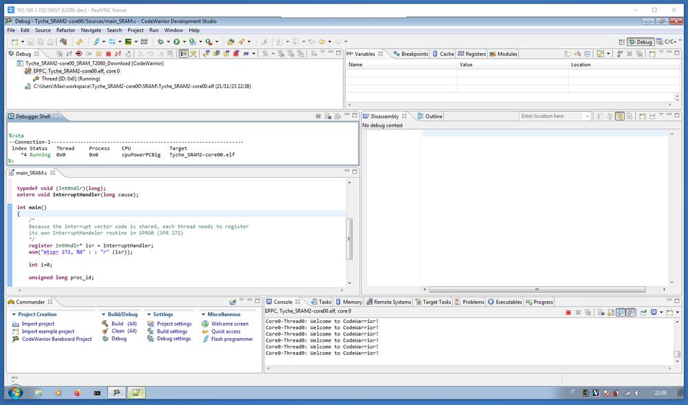

The output on the serial, but the text is illegible, on devkit the output is readable and is this:
Core0-Thread0: Welcome to CodeWarrior!

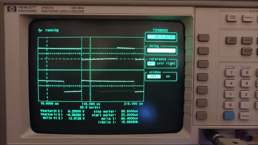

Powerboard Tyche serial output on the Oscilloscope
Powerboard Tyche serial output on the OscilloscopePowerboard Tyche serial output on the Oscilloscope

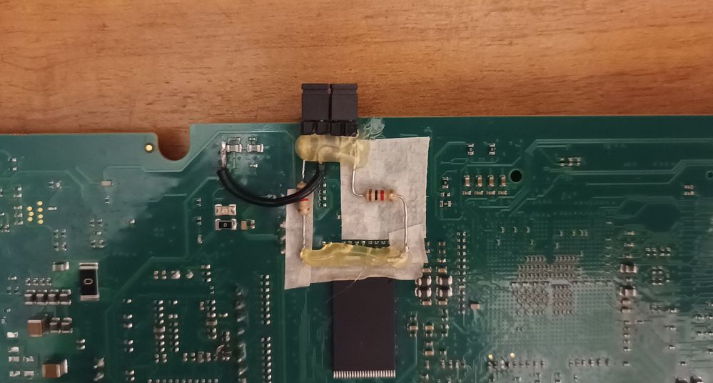

As our PowerBoard Tyche have not the third switch like the NXP T2080-RDB Devkit a few additional resistors were required to setup correctly the board to be able to switch on the Code Warrior debug connected to our Powerboard Tyche.
additional resistors due to the switches differences from devkitadditional resistors due to the switches differences from devkit

We observe on serial only a baud rate of 14-15Khjz instead of 1115KHz of T2080 Devkit

Check for HRESET_B, if negated it implies that RCW loading is complete.
Check for ASLEEP, if low it means that PBI is complete.
According to the waveform or your serial, it seems that the serial has already been initialized, it means u-boot has been loaded.
