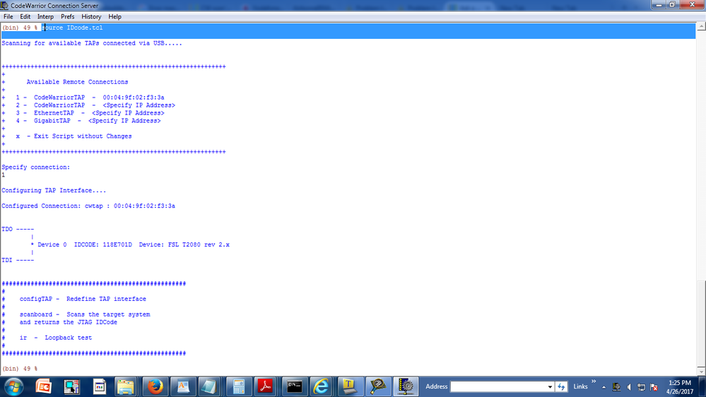

We have designed t2080 based custom board.
Processor is PORESET.

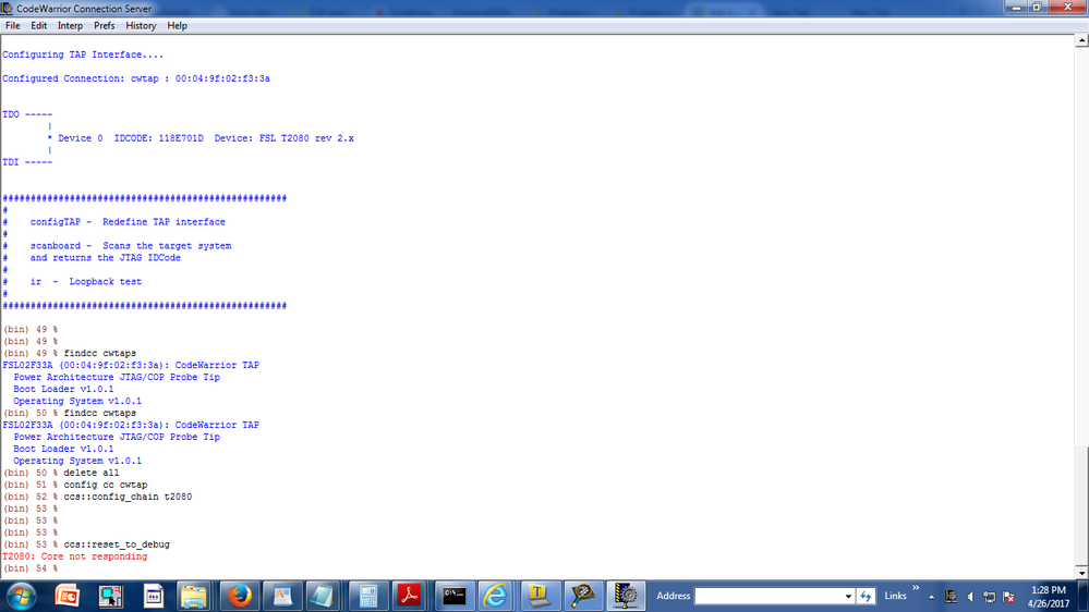

Trying to connect CW10.5  code warrior TAP to t2080.
If we run command source IDcode.tcl getting following response:
Getting T2080 Device id.
Then also run findcc cwtaps, delete all, config cc cwtap, ccs::config_chain t2080, ccs::reset_to_debug
Why T2080: Core not responding ?
Please let us know what could be issue?

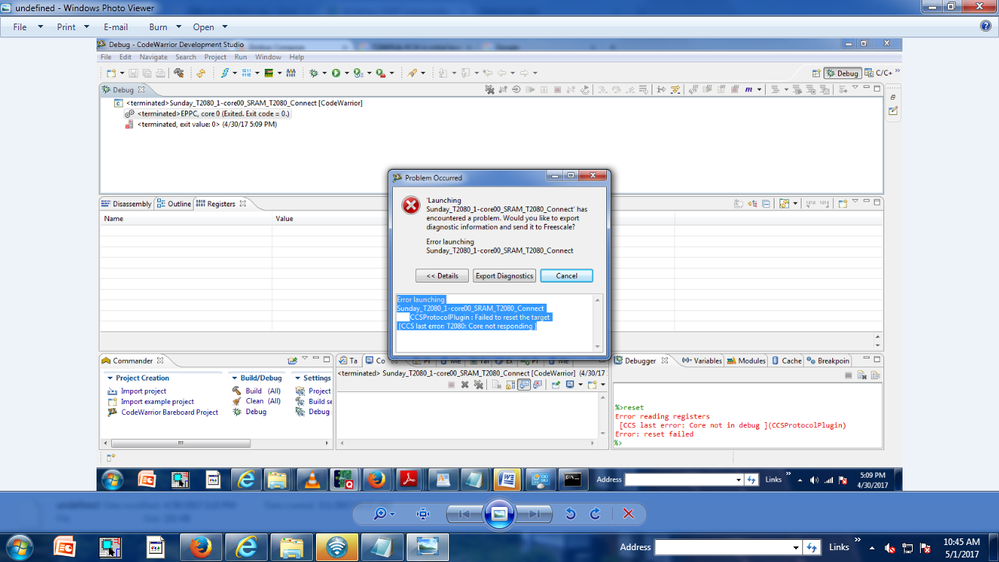

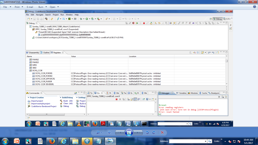

vidyasagartata
Dear Yiping,
In present scenario CW JTAG debug attach mode only work, but debug connect mode does not work.
(T2080 custom board is in hard code (0_1001_110x) mode, we are getting sys_clk 66.66MHz and DDR_CLK = 133.33MHz we tried DDR_CLK = 66.66 MHz also).
1). Debug attach mode screenshot.
If we run reset command in debugger shell gives error "error reading registers [ccs last error: Core not in debug ] (ccsProtocolPlugin) Error: reset failed"
2). Debug connect screenshot is attached.
Error: "CCSProtocolPlugin : Failed to reset the target
 [CCS last error: T2080: Core not responding ]"
We have also tried to override the RCW but getting error "CCSProtocolPlugin :JTAG connectuion error".
We have attached our generated RCW.
