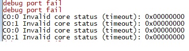

I am performing a board bring up for a custom board that uses the T1024NXN7MQA. I am not using the code warrior only the lauterbach jtag. At the beggining the lauterbach recognized the T1024 as T1014. We make some changes on the board. The lauterbach recognizes the correct IDCODE but once we try to perform a System.up I am getting a debug port failure indicating that CPU core 0 timeout and RCW cannot be read.
I think that this error is caused due that the HRESET is never asserted to low.

can you please post a screenshot of the AREA window (menu: View - Message Area) after the error occurred?
Did you check that the HRESET signal on your target hardware can actually be pulled to GND? If you don't see HRESET being asserted, it could mean either that the HRESET driver of the debug probe is not working, or that the HRESET signal of the target is tied to VCC.

Sure I attached the current area. I believe the hard coded RCW is not as expected since before this was causing an RESET_REQUEST_B.

I think you are right that the debugger didn't assert HRESET, as the failed access to the cores caused the SYStem.Up sequence to abort very early.
Do you know you can override the RCW with the debugger. There are two examples for NXP evaluation boards, which you can use as template and adopt for the needs of your hardware:
demo\powerpc64bit\hardware\qoriq_t1\t1024qds\demo_set_rcw.cmm
demo\powerpc64bit\hardware\qoriq_t1\t1024rdb\demo_set_rcw.cmm
in your TRACE32 installation folder.
